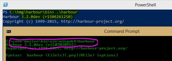

Pablo César wrote:
dhaine_adp wrote: May you inform us which Harbour version you got it, please ?
Pablo, please take a look the attached snapshot and compare the difference. The version from within the powershell is the one that comes from the latest HMG release.
