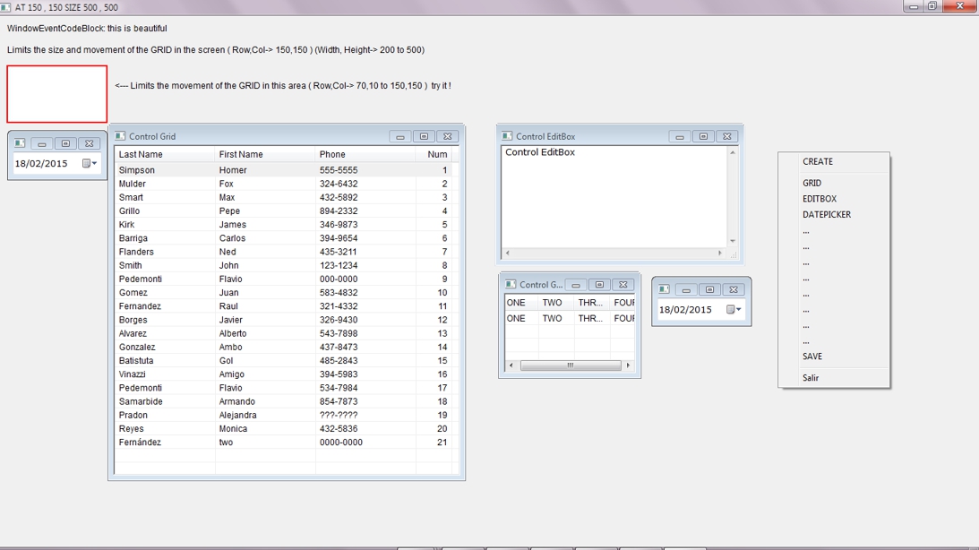

Great ! Thank you Claudio for new implements, so cool !! :D
Sorry I was out (in client attendance) I just arrived and I've tested, is 100% OK.
I updated my Demo is so good !
  WindowEventCodeBlock Demo
  Author: Dr. Claudio Soto
  A new more powerful concept: WindowEventCodeBlock
  Adapted Demo by Pablo César
  On February, 2015

Function Main()
Local aRows [21] [3]
Public hWnd, nIndex
aRows [1]   := {'Simpson','Homer','555-5555'}
aRows [2]   := {'Mulder','Fox','324-6432'}
aRows [3]   := {'Smart','Max','432-5892'}
aRows [4]   := {'Grillo','Pepe','894-2332'}
aRows [5]   := {'Kirk','James','346-9873'}
aRows [6]   := {'Barriga','Carlos','394-9654'}
aRows [7]   := {'Flanders','Ned','435-3211'}
aRows [8]   := {'Smith','John','123-1234'}
aRows [9]   := {'Pedemonti','Flavio','000-0000'}
aRows [10]   := {'Gomez','Juan','583-4832'}
aRows [11]   := {'Fernandez','Raul','321-4332'}
aRows [12]   := {'Borges','Javier','326-9430'}
aRows [13]   := {'Alvarez','Alberto','543-7898'}
aRows [14]   := {'Gonzalez','Ambo','437-8473'}
aRows [15]   := {'Batistuta','Gol','485-2843'}
aRows [16]   := {'Vinazzi','Amigo','394-5983'}
aRows [17]   := {'Pedemonti','Flavio','534-7984'}
aRows [18]   := {'Samarbide','Armando','854-7873'}
aRows [19]   := {'Pradon','Alejandra','???-????'}
aRows [20]   := {'Reyes','Monica','432-5836'}
aRows [21]   := {'Fernández','two','0000-0000'}
FOR i = 1 TO 21
    AADD (aRows[i],str(i))
DEFINE WINDOW Form_1 ;
   WIDTH 940 ;
   HEIGHT 750 ;
   TITLE "WindowEventCodeBlock Demo" ;
   MAIN ON PAINT Proc_OnPaint()
   @  10, 10 LABEL Label_1 ;
      width 80 ;
      height 20 ;
      value "Try to move out of yellow frame" ;
	  backcolor {255, 255, 102} ;
      autosize
   @  50, 10 LABEL Label_2;
      width 80;
      height 20;
      value "Limits the size and movement of the GRID in the screen (max Row,Col --> 150,150) (Width, Height --> 200 to 500)";
      autosize
   @  50, 700 CHECKBUTTON Button_1;
      caption "Disable Move/Resize Control";
      width 180;
	  height 28;
	  value .T.;
	  on change ControlIt(This.Value)
   @  100, 700 BUTTON Button_2;
      caption "Refresh Control";
	  action RefreshIt();
      width 180;
	  height 28
   @ 80,10 GRID Grid_1 ;
      WIDTH 540 ;
      HEIGHT 500 ;
      HEADERS {'Last Name','First Name','Phone',"Num"} ;
      WIDTHS {140,140,140,50};
      ITEMS aRows ;
      VALUE 1
      Form_1.Grid_1.ColumnCONTROL (4) := {"TEXTBOX", "NUMERIC",NIL,NIL}
      Form_1.Grid_1.ColumnJUSTIFY (4) := GRID_JTFY_RIGHT
hWnd := Form_1.Grid_1.Handle
HMG_ChangeWindowStyle (hWnd, WS_CAPTION + WS_SIZEBOX, NIL, .F., .T.)
SetWindowText(hWnd,"My Grid")
EnableChngPos()
MAXIMIZE WINDOW Form_1
ACTIVATE WINDOW Form_1

Re: WindowEventCodeBlock
Hola
Dr. Claudio, como que la función "SetWindowPos()" no actualiza las propiedades de ROW, COL, WIDTH, HEIGHT
IF flag == .T.
// esta función no altera las propiedades de ROW, COL, WIDTH, HEIGHT
SetWindowPos( hWnd, 0, x, y, cx, cy, SWP_NOOWNERZORDER + SWP_NOSENDCHANGING + SWP_DRAWFRAME + SWP_FRAMECHANGED )
// habrá que hacerlo manualmente ?
SetProperty( "Form_1", "Grid_1", "ROW", y )
SetProperty( "Form_1", "Grid_1", "COL", x )
SetProperty( "Form_1", "Grid_1", "WIDTH", cx )
SetProperty( "Form_1", "Grid_1", "HEIGHT", cy )
// RedrawWindow (GetParent (hWnd))
Return 0

		@  10 , 10  Label Label_1 WIDTH 80 HEIGHT 15 VALUE "WindowEventCodeBlock: this is beautiful" AUTOSIZE
		@  40 , 10  Label Label_2 WIDTH 80 HEIGHT 15 VALUE "Limits the size and movement of the GRID in the screen ( Row,Col-> 150,150 ) (Width, Height-> 200 to 500)" AUTOSIZE
		@  90 , 160 Label Label_3 WIDTH 80 HEIGHT 15 VALUE "<--- Limits the movement of the GRID in this area ( Row,Col-> 70,10 to 150,150 )  try it !" AUTOSIZE
		DRAW RECTANGLE IN WINDOW Form_1 AT 70 , 10 TO 150 , 150 PENCOLOR RED PENWIDTH 2 // FILLCOLOR <anFillColor>
		@ 150 , 150 GRID Grid_1 WIDTH 540 HEIGHT 500 HEADERS {'Name','Type','R-C-W-H|Value',"Coord."} WIDTHS {140,140,140,140} ITEMS aRows VALUE 1

	nIndex := SetEventCodeBlock (hWndGrid_1, {|| ProcMoveSizeControl()}, WM_WINDOWPOSCHANGED )   // Precess only this message
	ON KEY F5 OF Form_1 ACTION MsgDebug (RemoveEventCodeBlock (nIndex))
