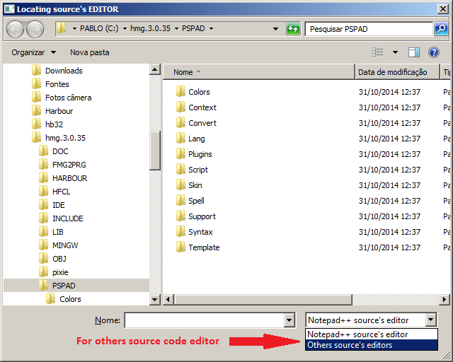

2 - I cannot select/add my fav Editor; in fact there is not a single EXE I can select from the GETFILE
It's no so necessary to define any source editor if you have not one defined. This is optional, when we wish to use our source code favorite editor. Most of us (I think) use Notepad++ and normally we make normal installation and when we do that, this source code editor turn on the default openner for .prg files in your system. If no one have been installed, please disregard this option. In other hand, if you have another source code editor than Notepad++ which you have been used you choose it for edition in this app. But please check if your favorite editor has a resource to locate to a specific line by parameter defined. This specific parameter will allow you to open the editor just at a specific line number.
If you found difficulties to select any source editor, see this picture below:
Do you think this selectable type of item should not exist ?
I confess I like Notepad++ a lot and maybe I push it much by this side. But it's by following reasons: it's freeware, nice resources and mainly by it has the option goto line when open file.
Please let me know your suggestion, if we cut this may let easier for user or it's ok like this ?

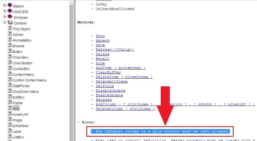

3 - Indentation is missing from source PRG
I think the main propose of GRID in this ViewError is to display the line, even at prompt command.
But there is an inconvenient for GRID at first column, please read this in HMGDoc:
I did not removed any spaces/tab (empty characters) at left of text. :?

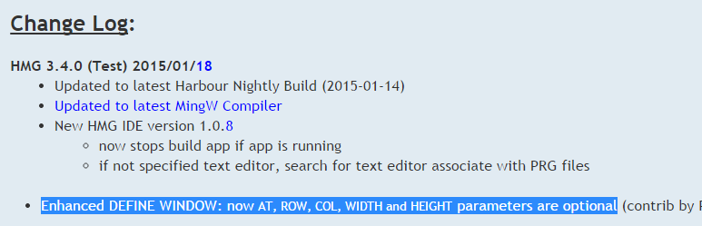

You have tried to compile with 3.3.1 and this app is been compiled with 3.4.0 because this:
Since last this release (3.4.0), it's optional: COL, ROW, WIDTH and HEIGHT when we DEFINE WINDOW.
Please check it around. <Click here for further information> In HMG older versions to define COL, ROW, WIDTH and HEIGHT are compulsory.

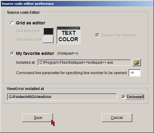

ViewError
Getting improvings...
  1. Top Most for main form
  2. Now not need Grid for displaying when favorite source editor have been choosen
  3. Resized main form occupying IDE area and letting source editor below of it.
  4. New parameters from Build.bat (HMG root folder, Path and hbp file name and 32/64 bits) for re-building option.
  5. Installer bug fixed
If you have already ViewError.exe got installed before, you do not need to Uninstall/Install it. You need only to replace ViewError.exe file where have been installed previously.
