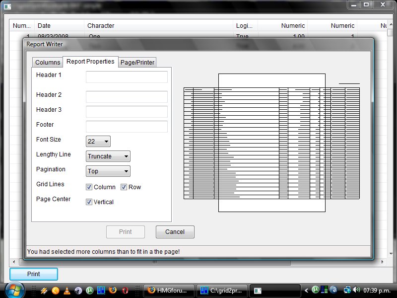

Re: Grid2Print - Suggestions
A little bug.rathinagiri wrote:Hi Friends,
Here comes the latest version of GridPrint with some bug fixes and changes:
When you select a big font size, causes preview problems:
Roberto.
- Image1.jpg (105.43 KiB) Viewed 27936 times
Regardsesgici wrote: ( At 13 Aug 2008 )
We ( Rathinagiri ) need a function such as
LenStrInPixel( <cString>, <aFont> ) --> <nLengthInPixel> (*)
(*) <aFont> : Font properties array: name, size, bold, italic ...
