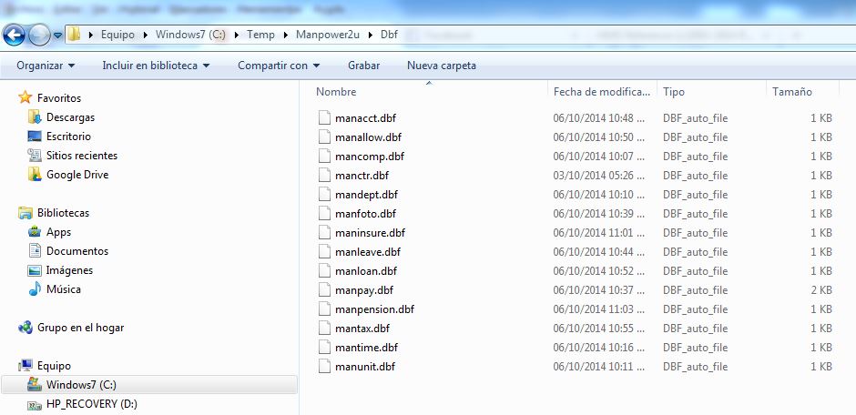

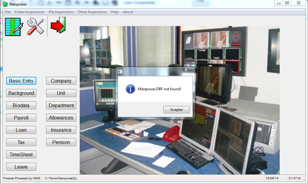

Hi Agil , ManPower.dbf not found , missing in .rar file
014-10-06 21_50_40-Dbf.jpg (65.1 KiB) Viewed 5068 times
Manpower2u.rar
(311.9 KiB) Downloaded 375 times

danielmaximiliano wrote:Hi Agil , ManPower.dbf not found , missing in .rar file

Hi friends...
About MANPOWER.DBF MANBACK.DBF MANBIO.DBF you must take them from my first attachment dated 3-10-14.
I don't include them with second attachment because there are no changes with the 3 DBF.
Thanks
