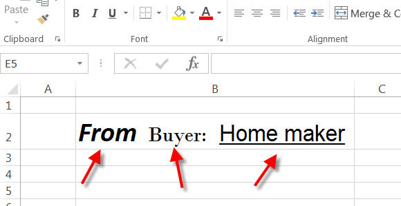

Sorry, I don't point out my question clearly. My question is as the picture below to set different font type and size in the excel "cell:B2". After several tried out, I found the solution to use the code like this ...
oSheet:Cells( alltrim(str(I+17)) , 6 ): Characters(Start:=1, Length:=34):Font:Size := 8
oSheet:Cells( alltrim(str(I+17)), 1 ): Characters(Start:=1, Length:=18):Font:Bold := .T.
Many thanks for your help.
