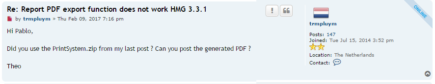

Thank for your answers. I surely used your example.
I would not say it worked for me without having tested your example ...
P.S. (Added later):
  • Sorry to be attached captured screen in my previous messages.
    I did this, because it was missing the message but now I see that you have redone the message.
