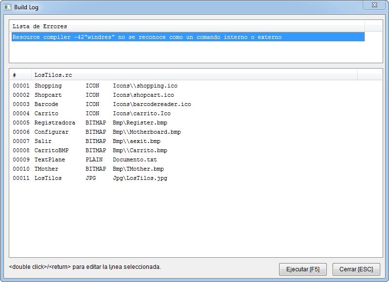

Claudio :
compilando con Windows Home premiun 64 en modo 32 la aplicacion se compila perfecto pero seleccionando modo 64 bit da una mensaje de error Windres.
te dejo la captura.
2014-05-26 11_04_24-Build Log.jpg (63.67 KiB) Viewed 9293 times

danielmaximiliano wrote:Claudio :
te dejo la captura.
Daniel,
en HMG.3.3.0 falta el parche que va a preparar Rathi con los compiladores de 64 bits.
in HMG.3.3.0 missing the patch that will prepare Rathi with 64-bit compilers.

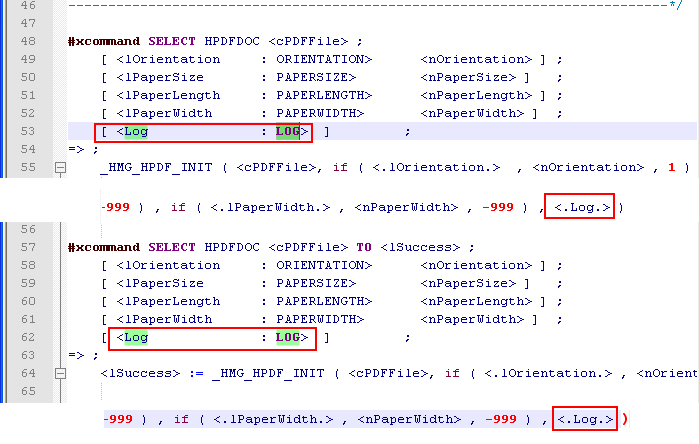

HMG 3.3.0 (Stable)
Posted: Tue May 27, 2014 1:37 am
Dear Rathi,
In _HMG_HPDF_INIT function we can count with lLog argument when developper wish to have a details of fonts applied for ttf and UNICODE ones. But this argument always is false, I mean there was not any parameter option at C:\hmg.3.3.0\INCLUDE\hmg_hpdf.ch.
Probably was has lost the include file due so many details and hard work for release composing. Please note below:
This do you think is possible to be included ? Please confirm.
File C:\hmg.3.3.0\SAMPLES\HPDF\Demo2_UniCode\Demo.prg is with error at compiling by this missing parameter.
