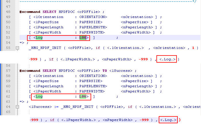

HMG 3.3.0 (Stable)
Dear Rathi,
In _HMG_HPDF_INIT function we can count with lLog argument when developper wish to have a details of fonts applied for ttf and UNICODE ones. But this argument always is false, I mean there was not any parameter option at C:\hmg.3.3.0\INCLUDE\hmg_hpdf.ch.
Probably was has lost the include file due so many details and hard work for release composing. Please note below: This do you think is possible to be included ? Please confirm.
File C:\hmg.3.3.0\SAMPLES\HPDF\Demo2_UniCode\Demo.prg is with error at compiling by this missing parameter.
