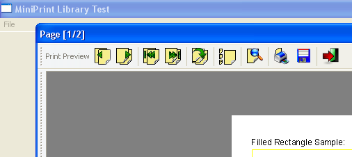

by emzampi
Greetings to all friends
I installed the HMG-32bits.3.3.0_Patch and I run (BuildAllLib.bat) this is done the print preview now I get distorted / incomplete as attached
Re: HMG 3.3.0 in 64 Bits (Test Version)
Posted: Wed Jun 04, 2014 9:19 am
by gfilatov
emzampi wrote:I installed the HMG-32bits.3.3.0_Patch and I run (BuildAllLib.bat) this is done the print preview now I get distorted / incomplete as attached
I'm confirm this strange toolbar's behavior in the print preview after applying the above patch also.
It seems that the source of problem is changes of the function INITTOOLBUTTON in the source c_toolbar.c :?
Posted: Wed Jun 04, 2014 12:34 pm
Sadly, I also confirm AFTER this first patch (HMG-32bits.3.3.0_Patch.zip) ToolBar's buttons are with bug.
BEFORE this patch, was OK.
So we shall wait for Dr. Soto returns and prepare a new patch to correct this bug.
My advise is not to be applied this first patch and wait for new instructions.

HMG 3.3.0 - Patch of ToolBarButtons
Posted: Wed Jun 04, 2014 1:19 pm
by srvet_claudio
Sorry friends,
please copy the attachment (c_toolbar.c) in c:\HMG.3.3.0\SOURCE
and run BuildAllLib.bat and _BuildAllLib64.bat
Posted: Wed Jun 04, 2014 1:26 pm
by dragancesu
Thank you,
problem with images in the toolbar is resolved
Posted: Wed Jun 04, 2014 1:40 pm
by bpd2000
Thank you Dr. Claudio Soto, Toolbar error clear
Posted: Wed Jun 04, 2014 1:49 pm
Hola Claudio, despues de este nuevo c_toolbar.c los botones volvieron pero todavia están con una exibicion diferente.
La imagen del los botones deberia ser como esta:
Pablo César wrote:Claudio, solo para informacion: la exibicion de los bmp del preview, no están con buena resolucion. Creo que el color negro lo está removiendo.
Que lo que falta hacer ? Es el transparent ?
Posted: Wed Jun 04, 2014 3:24 pm
by srvet_claudio
Pablo César wrote:Hola Claudio, despues de este nuevo c_toolbar.c los botones volvieron pero todavia están con una exibicion diferente.
Hi all,
Unzip the attachment folder in c:\HMG.3.3.0\RESOURCES
