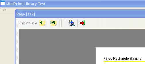

I installed the HMG-32bits.3.3.0_Patch and I run (BuildAllLib.bat) this is done the print preview now I get distorted / incomplete as attached

emzampi wrote:I installed the HMG-32bits.3.3.0_Patch and I run (BuildAllLib.bat) this is done the print preview now I get distorted / incomplete as attached
I'm confirm this strange toolbar's behavior in the print preview after applying the above patch also.
It seems that the source of problem is changes of the function INITTOOLBUTTON in the source c_toolbar.c :?

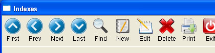

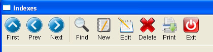

I left an example and how look in program, pictures are BMP
For me the problem with the keyword SEPARATOR works well when there is no
      DEFINE TOOLBAR ToolBar_2_1 BUTTONSIZE 60,40 IMAGESIZE 32,32 FLAT BORDER
      BUTTON FIRST_2604 ;
         CAPTION "First" ;
         PICTURE "go_first" ;
         ACTION( dbGotop(), Win_2_1.Browse_2_1.Value := RecNo() )
      BUTTON PREV_2604 ;
         CAPTION "Prev" ;
         PICTURE "go_prev" ;
         ACTION( dbSkip( -1 ), Win_2_1.Browse_2_1.Value := RecNo() )
      BUTTON NEXT_2604 ;
         CAPTION "Next" ;
         PICTURE "go_next" ;
         ACTION( dbSkip(), if ( Eof(), dbGobottom(), Nil ), Win_2_1.Browse_2_1.Value := RecNo() )
      BUTTON LAST_2604 ;
         CAPTION "Last" ;
         PICTURE "go_last" ;
         ACTION( dbGoBottom(), Win_2_1.Browse_2_1.Value := RecNo() )  /* SEPARATOR */

Sadly, I also confirm AFTER this first patch (HMG-32bits.3.3.0_Patch.zip) ToolBar's buttons are with bug.
BEFORE this patch, was OK.
So we shall wait for Dr. Soto returns and prepare a new patch to correct this bug.
My advise is not to be applied this first patch and wait for new instructions.
Claudio, solo para informacion: la exibicion de los bmp del preview, no están con buena resolucion. Creo que el color negro lo está removiendo.

Thank you,
problem with images in the toolbar is resolved
Re: HMG 3.3.0 in 64 Bits (Test Version)
Thank you Dr. Claudio Soto, Toolbar error clear

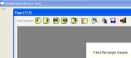

Hola Claudio, despues de este nuevo c_toolbar.c los botones volvieron pero todavia están con una exibicion diferente.
La imagen del los botones deberia ser como esta:
Pablo César wrote:Claudio, solo para informacion: la exibicion de los bmp del preview, no están con buena resolucion. Creo que el color negro lo está removiendo.
Que lo que falta hacer ? Es el transparent ?

Pablo César wrote:Hola Claudio, despues de este nuevo c_toolbar.c los botones volvieron pero todavia están con una exibicion diferente.
Hi all,
Unzip the attachment folder in c:\HMG.3.3.0\RESOURCES
