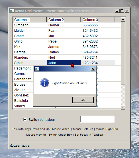

How to catch mouse event in a grid ?
Thanks to Jean Pierre (Nick name: jpp) and Claudio implementations, I could make it a better example:
   Grid Events Demo
   Demo1.prg - Right click identification for each Grid column
   Enhanced by Pablo César Arrascaeta
   On March 7th, 2015
#define DO_EVENT    Nil
#define NO_EVENT    1
Function Main()

DEFINE WINDOW Form_1 ;
    WIDTH 430 ;
    HEIGHT 500 ;
    TITLE 'Grid Events Demo - EventProcessAllHookMessage' ;
    MAIN NOSIZE
    DEFINE STATUSBAR FONT "Courier New" SIZE 9
        STATUSITEM PadC("",75)
    END STATUSBAR
    @ 10,10 GRID Grid_1 ;
        WIDTH 400 ;
        HEIGHT 330 ;
        HEADERS {'Column 1','Column 2','Column 3'} ;
        WIDTHS {120,120,120} ;
		ITEMS aRows ;
        VALUE 1 ;
        CELLNAVIGATION
    @ 360, 50 CHECKBOX Check_1 CAPTION 'Switch behaviour' WIDTH 150 VALUE .T.
    @ 360, 250 TEXTBOX Text_1 ;
        VALUE "" ;
        TOOLTIP 'Just Setting Focus and test'
    @ 400,10 LABEL Label_1 VALUE "Test with: keys Down and Up | Mouse Wheel | Mouse Left Btn | Mouse Right Btn" WIDTH 400 HEIGHT 20 FONT 'Arial' SIZE 8
    @ 420,60 LABEL Label_2 VALUE "Mouse moving | Switch Check Box | Set Focus in TextBox" WIDTH 400 HEIGHT 20 FONT 'Arial' SIZE 8
CREATE EVENT PROCNAME Check_Grid_Events() HWND Form_1.Grid_1.HANDLE STOREINDEX nIndex
EventProcessAllHookMessage (nIndex, .T.)
// CREATE EVENT PROCNAME Check_Event_Form()
CENTER WINDOW Form_1
ACTIVATE WINDOW Form_1
Function Check_Event_Form()
Local WM_:=EventMSG()
IF EventHWND() == Form_1.HANDLE
   DO CASE
      CASE WM_ == WM_KEYDOWN
           msgbox("key_down")
      CASE WM_ == WM_MOUSEWHEEL
           msgbox("Mouse wheel")
      CASE WM_ == WM_LBUTTONDOWN
           msgbox("Mouse lbtn Down")
      CASE WM_ == WM_RBUTTONDOWN
           msgbox("Mouse Rbtn Down")
   ENDCASE
Function Check_Grid_Events()
Local nMsg := EventMsg()
Local xRet := DO_EVENT
Local aCell
DO CASE
   CASE nMsg == WM_KEYUP
        cMsg:="key_up"
        xRet:=NO_EVENT
   CASE nMsg == WM_KEYDOWN
        cMsg:="key_down"
        xRet:=NO_EVENT
   CASE nMsg == WM_MOUSEWHEEL
        cMsg:="Mouse wheel"
        xRet:=NO_EVENT
   CASE nMsg == WM_MOUSEMOVE
        cMsg:="Mouse move"
        xRet:=NO_EVENT
   CASE nMsg == WM_LBUTTONDOWN
        cMsg:="Mouse lbtn Down"
   CASE nMsg == WM_RBUTTONDOWN
        cMsg:="Mouse Rbtn Down"
		aCell:=GetCellClicked("Form_1","Grid_1")
		SetProperty("Form_1","Grid_1","Value",aCell)
		MsgInfo("Right-Clicked on Column "+AllTrim(Str(aCell[2])))
ENDCASE
If GetProperty("Form_1","Check_1","Value")=.T.
   xRet:=If(xRet==DO_EVENT,NO_EVENT,DO_EVENT)
Endif
Form_1.StatusBar.Item(1):=cMsg
Return xRet
Function GetCellClicked(cForm,cControl)
Local aRet, nIndex:=GetControlIndex(cControl,cForm)
Local aCellData:=_GetGridCellData(nIndex)
aRet:={aCellData[1],aCellData[2]}
Return aRet
This example can ilustrate how events can be so helpful for us. Of course this code could it get better.
But there is an extra feature to get CellClicked on Right-Button in the grid.
I hope be useful ! :D

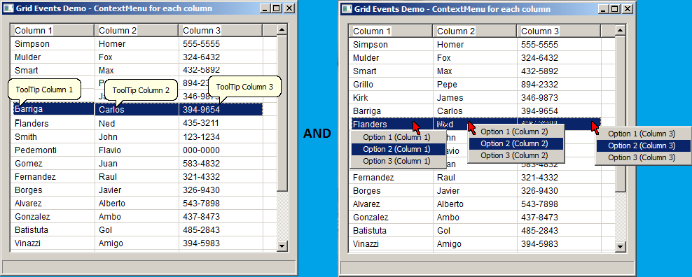

After identifying with Right-Button clicked on Grid column, it's easy to implement personalized ContextMenu:
   Grid Events Demo
   Demo2.prg - ContextMenu and ToolTip for each Grid column
   On March 7th, 2015
Local aCell, nMsg := EventMsg()
Static cCtrlSelected:=""
If nMsg == WM_RBUTTONDOWN
   Define_Control_Context_Menu("Form_1","Grid_1",aCell[2])
Endif

Function Define_Column_ToolTip(cParentForm,cControl)
Local nColumn:=GetProperty(cParentForm,cControl,"CellColFocused")
Do Case
   Case nColumn=1
        _SetToolTip(cControl,cParentForm,"ToolTip Column 1")
   Case nColumn=2
        _SetToolTip(cControl,cParentForm,"ToolTip Column 2")
   Case nColumn=3
        _SetToolTip(cControl,cParentForm,"ToolTip Column 3")
EndCase
I've included a personalized ToolTip for each column of grid too. It's not the best way, but at least I got something to show. I make this thru ON CHANGE event.
It's look like this:
I hope be useful too ! :D
