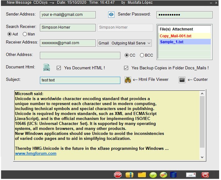

Hola amigos:
Dejo un Sample basado en el magnífico trabajo
aportado por DaNiElMaXiMiLiAnO con su Sample
CDOsys de envío de Correo.
Me propuse crear un fichero HTML con un Logo
e incrustarlo en el cuerpo del eMail (color de
fondo, elección tipo de letra, color letra, etc )
No como un > Attached <
El objetivo lo he conseguido a medias ...
Funciona desde el Sample a ==> Gmail --OK!!-- :lol:
Pero desde ==> Outlook no está saliendo
correcto y tampoco desde el Sample a ==> Yahoo :(
Ver Carpeta Help_Config ==>"Screenshot.jpg"
ver también en misma carpeta "Readme.txt"
Ver Errores ?
Bueno amigos espero que sea de su agrado
Un Saludo

Hello friends:
I leave a Sample based on the magnificent work
provided by DaNiElMaXiMiLiAnO with its Sample
Mail shipping CDOsys.
I decided to create an HTML file with a Logo
and embed it in the body of the eMail (color of
background, font choice, font color, etc )
Not as an > Attached <
I have half achieved the goal ...
Works from Sample to ==> Gmail --OK !! - :lol:
But since ==> Outlook is not exiting
correct and neither from the Sample a ==> Yahoo! :(
See Help_Config Folder ==> "Screenshot.jpg"
see also in the same folder "Readme.txt"
View Errors ?
Well friends I hope you like it
Mail_CDOsys_2020.zip
(1.41 MiB) Downloaded 255 times
