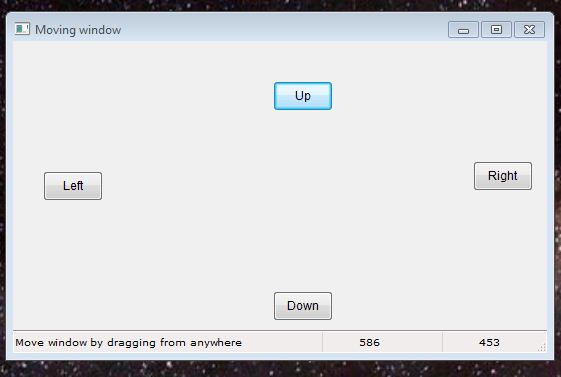

esgici wrote: ...
I hope attached sample will help you :arrow:
Another "Move Window" implementation :
Move Window - 2 ( with dragging method )
MoveWin2.zip
Source (.prg) file for Move Win-2
(1.02 KiB) Downloaded 395 times
This recalled me Law of the instrument ;)
