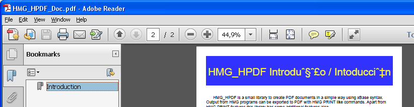

Rathinagiri wrote:Actually, what is your problem?
The problem is not making brazilian or spanish accents (especial characters from the language). I have tested in HMG 3.0.46 and 3.1.3 in UNICODE and ANSI code. But sadly, do not work with accents with harupdf.
This is a code example:

Look at this is wrong characteres displayed:

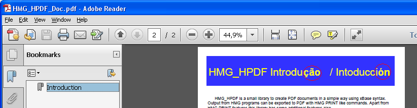

And this is the right ones to be displayed (this was made by PaintBrush):
So it is somthing wrong and now with UNICODE most probably will be so usefull if accents characters could be displayed in good order...
Re: Problema con HaruPDF
HMGpdf unicode is not yet supported. We (Claudio and myself) had checked and tried to ANSI version to Unicode and failed. But trying...

Just use:
HMG_HPDF_SetEncoding( HPDF_ENCODING_WIN_ANSI )

SET HPDFDOC ENCODING TO HPDF_ENCODING_WIN_ANSI
or

Hola Andrés, si pones:
_HMG_HPDF_SetEncoding("ISO8859-3") o _HMG_HPDF_SetEncoding("WinAnsiEncoding")
Antes de tu START HPDFDOC creo que funcionará bien para el español. Yo hice un pequeño test y me funcionó, fijate.
Hi Andrew, if you add this
_HMG_HPDF_SetEncoding ("ISO8859-3") or _HMG_HPDF_SetEncoding ("WinAnsiEncoding")
Put it before line of HPDFDOC START and will work well for Spanish. I did a little test and it worked as well. Look up.

Oi Hasa, se você inserir en seu código:
_HMG_HPDF_SetEncoding("ISO8859-9") ou _HMG_HPDF_SetEncoding("WinAnsiEncoding")
Antes do START HPDFDOC creio que funcionará bem para o português. Eu fiz um pequeno teste e deu certo, veja ai se funciona. Mas na versão de HMG 3.0.46
Hi Hasa, if you add this
_HMG_HPDF_SetEncoding ("ISO8859-9") or _HMG_HPDF_SetEncoding ("WinAnsiEncoding")
Put it before line of HPDFDOC START and will work well for Portuguese. I did a little test and it worked as well. But in HMG 3.0.46 version.
