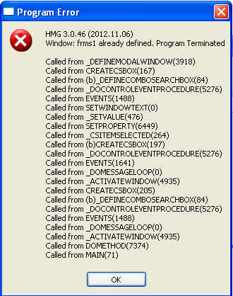

rathinagiri wrote:Well, I am getting a Run time error here.
Me too!
My windows version is XP.
Re: Problema con combosearchbox/ problem combosearchbox
Even in version 3.1.1 also I am getting the same error.
Can you please upload your exe file?
Me too!
Same case: http://hmgforum.com/viewtopic.php?p=25643#p25643, Jairo. Change to 3.1.1

Pablo,
The same RTE occurs with version 3.1.0 too
As Pablo said : Sorry, sorry and sorry :(
But you didn't warn us "after selected an item" :(
I'll continue to search; because trailing space should not cause an error like this.
rathinagiri wrote:Even in version 3.1.1 also I am getting the same error.
yes sure ! Look now with my exe file, also note Municipios.lst is UTF-8 format. Please also overwrite your, probably your editor has changed format...
Jairo Maia wrote:Pablo,
Please change to 3.1.1 and check Municipios.lst format in Notepad++
esgici wrote:As Pablo said : Sorry, sorry and sorry :(
Caramba ! I made mistake again... sorry for everybody !
Mr. Rathinagiri and Jairo were right (also me at begining, probably Esgici influences on me, :lol: ) ! There is a RTE afeter selecting. And for ComboSearBox needs for triming space in each elements. Was right for beginig, sorry (today I have awaike up at 4h in morn, due to my coughing fit). My apologies, colleagues !
So Mr. Esgici, start again with these problem, probably you should treat in your code, just to avoid future problems in case not trimed spaces.
For the right display, please use UNICODE format when Municipios.lst is in same format.
