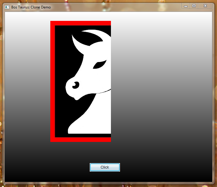

Is possible to load part of an image ? I means is there any function to show just one region of an image ?

Found a function in BosTaurus\doc :
BT_BitmapClone (hBitmap, Row, Col, Width, Height)
Clones the specified bitmap and returns a handle to the cloned bitmap.
hBitmap: is a handle to the origin bitmap.
Row, Col, Width, Height: specifies the dimensions in pixels of the rectangle to clone.
For default: Row = 0, Col = 0, Width = BT_BitmapWidth(hBitmap), Height =
BT_BitmapHeight(hBitmap).
I don't know is this correct way, but it works :arrow:
Left half of Bos Taurus logo
BT_CloneDemo.zip
Bos Taurus clone demo source files ( .prg & hbp )
(1.12 KiB) Downloaded 434 times
I hope it will help you
