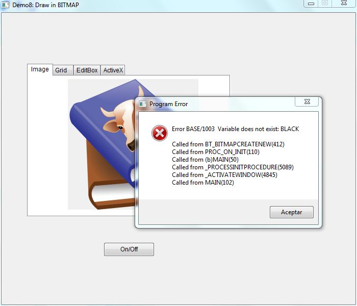

Hola Claudio:
Muy bueno su trabajo. Felicitaciones.
el ejemplo 8 contiene un error, adjunto image.
Demo8 Draw in BITMAP_2012-11-02_23-12-52.jpg (43.07 KiB) Viewed 6383 times
Re: HMG 3.0.45
srvet_claudio wrote:el ejemplo 8 contiene un error, adjunto image.
Hi Daniel.
This is a bug of inclusion the headers files when compiling the library hfcl.a
because BLACK is a native matrix of HMG (i_color.ch) defined as:
#define BLACK {0, 0, 0}
In line 110 of demo8.prg replace:
hBitmap: = BT_BitmapCreateNew (800, 600)
by:
hBitmap: = BT_BitmapCreateNew (800, 600, BLACK)
Best regards,
Claudio.
