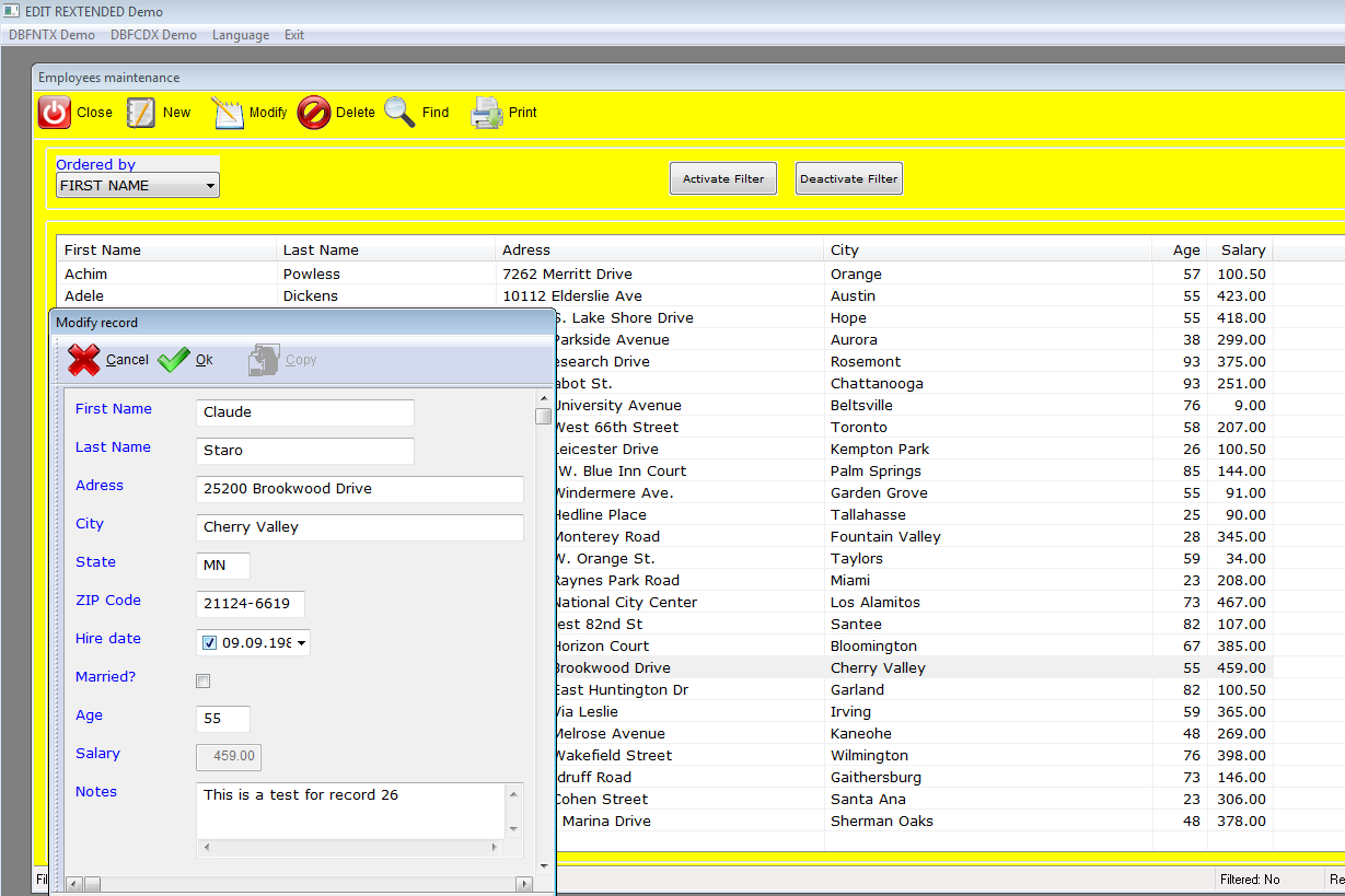

This is my humble work for you; I hope will give you an idea :idea:
EditRExt.zip
Edit Re-Extended source files
(37.79 KiB) Downloaded 441 times
Edit Re-Extended Screen shoot
