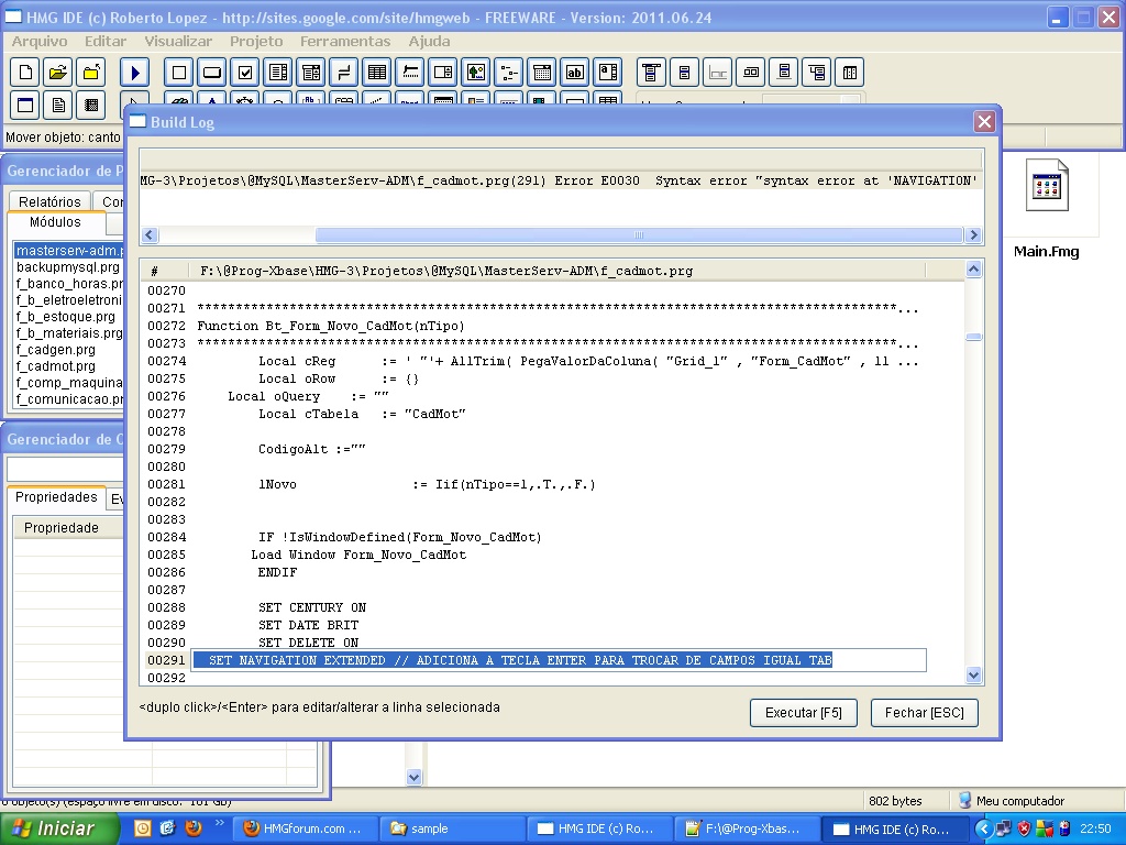

in the new IDE is showing syntax error in set navigation as attachment if someone knows something please post moved
erro set navigation.jpg (272.78 KiB) Viewed 5208 times

Re: HMG 3.0.40
There is a problem with F8 key in IDE ver. 2011.06.24, I think.
It doesn't call compilation with debug, but normal compilation.
Marek
