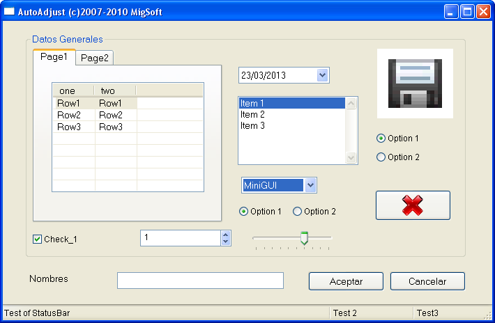

Thank you Esgici, it has worked OK !
Now I have included some more elements, please check if is ok.
Function Main()
Private cForm:='Principal'
DEFINE WINDOW  Principal AT 126,66 WIDTH 648 HEIGHT 464 ;
	TITLE 'AutoAdjust (c)2007-2010 MigSoft ' MAIN;
    ON INIT Autoaj(cForm) ;
    ON SIZE Autoaj(cForm) ;
    ON MAXIMIZE Autoaj(cForm)
    @ 18,31 FRAME frame_1 CAPTION "Datos Generales" ;
		WIDTH 576 HEIGHT 321
		principal.frame_1.fontcolor:={0,0,0}
		principal.frame_1.fontname:='MS Sans Serif'
		principal.frame_1.fontsize:= 10
    @ 40,491 IMAGE image_1 PICTURE "HP_SAVE" ;
		WIDTH 100 HEIGHT 100 STRETCH
    @ 66,309 DATEPICKER datepicker_1 WIDTH 120 ;
		FONT 'MS Sans Serif' SIZE 10
		principal.datepicker_1.fontcolor:={0,0,0}
		principal.datepicker_1.backcolor:={255,255,255}
    DEFINE TAB tab_1 AT 40,40 WIDTH 250 HEIGHT 250 ;
		DEFINE PAGE " Page1 "
            @ 48,24 GRID grid_1 WIDTH 200 HEIGHT 158 ;
				HEADERS {'one','two'} WIDTHS  {60,60} ;
                principal.grid_1.fontcolor:={0,0,0}
				principal.grid_1.AddItem( {"Row1","Row1"} )
                principal.grid_1.AddItem( {"Row2","Row2"} )
                principal.grid_1.AddItem( {"Row3","Row3"} )
                principal.grid_1.value:=1
        END PAGE
        DEFINE PAGE " Page2 "
            @ 121,29 PROGRESSBAR progressbar_1 ;
                WIDTH 191 HEIGHT 34 VALUE 25
                principal.progressbar_1.fontcolor:={0,0,0}
          END PAGE
    END TAB
    @ 108,308 LISTBOX list_1 WIDTH 158 HEIGHT 99 ;
        principal.list_1.fontcolor:={0,0,0}
        principal.list_1.backcolor:={255,255,255}
		principal.list_1.AddItem( "Item 1" )
        principal.list_1.AddItem( "Item 2" )
        principal.list_1.AddItem( "Item 3" )
        principal.list_1.value:=1
    @ 224,313 COMBOBOX combo_1 WIDTH 100 VALUE 2;
        FONT 'MS Sans Serif' SIZE 10 ;
        ITEMS {"MiniGUI","HMG","ooHG"}
        principal.combo_1.fontcolor:={0,0,0}
        principal.combo_1.backcolor:={255,255,255}
	@ 243,488 BUTTON picbutt_3 PICTURE 'HMG_EDIT_CANCEL';
        ACTION msginfo('Pic button pressed') WIDTH 100 HEIGHT 44
	DEFINE RADIOGROUP RadioGroup_1
        ROW    155
        COL    490
        WIDTH  100
        HEIGHT 50
        OPTIONS { 'Option 1','Option 2'}
        VALUE 1
        FONTNAME "Arial"
        FONTSIZE 9
        TOOLTIP ""
        ONCHANGE Nil
        FONTBOLD .F.
        FONTITALIC .F.
        FONTUNDERLINE .F.
        FONTSTRIKEOUT .F.
        HELPID Nil
        TABSTOP .T.
        VISIBLE .T.
        TRANSPARENT .F.
        SPACING 27
        BACKCOLOR Nil
        FONTCOLOR Nil
        READONLY Nil
        HORIZONTAL .F.
    END RADIOGROUP
	DEFINE RADIOGROUP RadioGroup_2
        ROW    260
        COL    310
        WIDTH  160
        HEIGHT 28
        VALUE 1
        FONTNAME "Arial"
        FONTSIZE 9
        TOOLTIP ""
        ONCHANGE Nil
        FONTBOLD .F.
        FONTITALIC .F.
        FONTUNDERLINE .F.
        FONTSTRIKEOUT .F.
        HELPID Nil
        TABSTOP .T.
        VISIBLE .T.
        TRANSPARENT .F.
        SPACING 70
        BACKCOLOR Nil
        FONTCOLOR Nil
        READONLY Nil
        HORIZONTAL .T.
    END RADIOGROUP
	DEFINE STATUSBAR FONT "Arial" SIZE 9
        STATUSITEM "Test of StatusBar"
        STATUSITEM "Test 2"
        STATUSITEM "Test3"
    END STATUSBAR
	DEFINE CHECKBOX Check_1
        ROW    300
        COL    40
        WIDTH  100
        HEIGHT 28
        CAPTION "Check_1"
        VALUE .F.
        FONTNAME "Arial"
        FONTSIZE 9
        TOOLTIP ""
        ONCHANGE Nil
        ONGOTFOCUS Nil
        ONLOSTFOCUS Nil
        FONTBOLD .F.
        FONTITALIC .F.
        FONTUNDERLINE .F.
        FONTSTRIKEOUT .F.
        BACKCOLOR NIL
        FONTCOLOR NIL
        HELPID Nil
        TABSTOP .T.
        VISIBLE .T.
        TRANSPARENT .F.
    END CHECKBOX
	DEFINE SPINNER Spinner_1
        ROW    300
        COL    180
        WIDTH  120
        HEIGHT 24
        RANGEMIN 1
        RANGEMAX 10
        VALUE 0
        FONTNAME "Arial"
        FONTSIZE 9
        TOOLTIP ""
        ONCHANGE Nil
        ONGOTFOCUS Nil
        ONLOSTFOCUS Nil
        FONTBOLD .F.
        FONTITALIC .F.
        FONTUNDERLINE .F.
        FONTSTRIKEOUT .F.
        HELPID Nil
        TABSTOP .T.
        VISIBLE .T.
        WRAP .F.
        READONLY .F.
        INCREMENT 1
        BACKCOLOR NIL
        FONTCOLOR NIL
    END SPINNER
    DEFINE SLIDER Slider_1
        ROW    300
        COL    320
        WIDTH  120
        HEIGHT 35
        RANGEMIN 1
        RANGEMAX 10
        VALUE 0
        TOOLTIP ""
        ONCHANGE Nil
        HELPID Nil
        TABSTOP .T.
        VISIBLE .T.
        BACKCOLOR NIL
    END SLIDER
	@ 362,35 LABEL label_1 WIDTH 95 HEIGHT 21 ;
		VALUE 'Nombres' FONT 'MS Sans Serif' SIZE 10
		principal.label_1.fontcolor:={0,0,0}
    @ 361,150 TEXTBOX text_1 HEIGHT 24 WIDTH 219 ;
		Font 'MS Sans Serif' size 10 MAXLENGTH 30
		principal.text_1.fontcolor:={0,0,0}
		principal.text_1.backcolor:={255,255,255}
	@ 360,400 BUTTON button_1 CAPTION 'Aceptar' ;
		ACTION msginfo('Button pressed') WIDTH 100 HEIGHT 28 ;
		principal.button_1.fontcolor:={0,0,0}
    @ 360,507 BUTTON button_2 CAPTION 'Cancelar' ;
		principal.button_2.fontcolor:={0,0,0}
CENTER WINDOW principal
Activate Window principal
Function ISAPPXPTHEMED()
Return ( OS_ISWINXP_OR_LATER() .AND. IsAppThemed() )
Function AutoAj()
_AutoAdjust((GetFormHandle(cForm)) )
Function _AutoAdjust( hWnd )
Local i, k, ParentForm, ControlCount, ControlName, ControlType, nWidth, nHeight, lvisible:=.T., nDivw, nDivh
IF GetDesktopWidth() < GetWindowWidth ( hWnd )
   nWidth := GetDesktopWidth()
   nWidth := GetWindowWidth ( hWnd )
IF GetDesktopHeight() < GetWindowHeight ( hWnd )
   nHeight := GetDesktopHeight()
   nHeight := GetWindowHeight ( hWnd )
IF IsWindowVisible ( hWnd ) .And. ! IsAppXPThemed()
   HideWindow ( hWnd )
   lvisible := .F.
i := aScan ( _HMG_SYSDATA[67] , hWnd )
ParentForm := _HMG_SYSDATA[66] [i]
if _HMG_SYSDATA[92] [i] > 0 .and. _HMG_SYSDATA[91] [i] > 0
   nDivw := nWidth / _HMG_SYSDATA[92] [i]
   nDivh := nHeight / _HMG_SYSDATA[91] [i]
   nDivw := 1
   nDivh := 1
ControlCount := Len ( _HMG_SYSDATA[3] )
For k := 1 To ControlCount
    ControlName := _HMG_SYSDATA[2] [k]
    if _IsControlDefined ( ControlName, ParentForm )
       ControlType := _HMG_SYSDATA[1] [k]
       if !Empty( ControlName ) .And. !( ControlType $ "MENU,HOTKEY,TOOLBAR,MESSAGEBAR,ITEMMESSAGE,TIMER" ) //.And.;
          //Empty( GetControlContainerHandle ( ControlName, ParentForm ) )
          if ControlType == 'RADIOGROUP'
             _HMG_aControlSpacing     := _HMG_SYSDATA[ 22 ]
             _HMG_aControlMiscData1   := _HMG_SYSDATA[  8 ]
             _HMG_aControlSpacing [k] := _HMG_aControlSpacing [k] * iif(_HMG_aControlMiscData1 [k], nDivw, nDivh)
		  if ControlType <> "STATUSBAR"
		     _SetControlSizePos ( ControlName, ParentForm,;
             _GetControlRow ( ControlName, ParentForm ) * nDivh, _GetControlCol ( ControlName, ParentForm ) * nDivw,;
             _GetControlWidth ( ControlName, ParentForm ) * nDivw, _GetControlHeight ( ControlName, ParentForm ) * nDivh )
          if ControlType <> 'SLIDER'
	         if empty(_HMG_SYSDATA[28] [k] )
 		        _SetFontSize ( ControlName, ParentForm , 8 * nDivh )
  		        _SetFontSize ( ControlName, ParentForm , _HMG_SYSDATA[28] [k] * nDivh )
Next k
_HMG_SYSDATA[92]  [i] := nWidth
_HMG_SYSDATA[91] [i] := nHeight
IF lvisible
   ShowWindow ( hWnd )
This is a new screen:
After redimensioning several times, still ocurrs an error of RTE (Desktop with white scrren, I think this is the name: RTE ?).
Re: Consulta sobre resolución de pantalla.
Olá Pablo
I'm glad that you too continuing to searching the better like me :)
I found the problem with Status Bar : this is special control ( really this is a real control or anything else ? ) that not have "size" and "location" properties, because it has fixed size and location; so we need isolate actual size and location ( position ) changing block from status bar :
            IF ControlType # 'STATUSBAR'
               _GetControlRow ( ControlName, ParentForm ) ;
               _GetControlWidth ( ControlName, ParentForm ) * ;
But auto-adjust affairs not finished yet ;)
Now I'm working apply auto-adjust feature to our famous sample MAIN.DEMO.
And now we have another problem other than RTE ( Run Time Error ) : if user use MAXIMIZE button before re-sizing form, auto-adjust doesn't work :?
TIA :D
esgici wrote:I'm glad that you too continuing to searching the better like me :)
yes sure and it is my pleasure too. :P
So it is the same that I already posted ! Only differance you are using a "#" and me "<>". For size property is different for STATUSBAR, I have seem that !
What differance is ?
For me it is not reproducing a RTE. For it is normal, even maximizing and resizing (before, after) so in this posted example.
What more is missing ??
Olá Pablo
Found my fault !
While adding ON MAXIMIZE clause missed ON INIT :(
Added and problem solved.
This isn't interesting; without ON INIT AutoAdjust(), ON MAXIMIZE AutoAdjust() doesn't work
( If "Maximize" button of form clicked before any re-sizing) :?
Now, everything seems to be OK about AutoAdjust()
Thanks all your participation to achieve this level.
