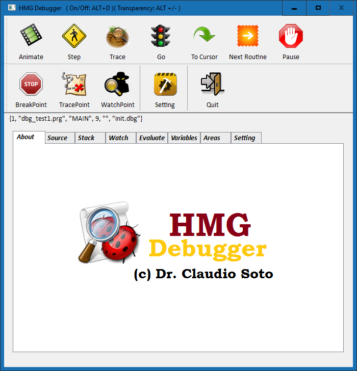

Hi All,
please test this patch, now HMG contain a native true GUI DEBUGGER.
The difference with others debuggers is that HMG Debugger overlaps the windows message loop and does not stop or crash the system when a windows is activated.
Compile with:
- build.bat /d app.hbp
or
- build.bat -b app.hbp
Brief Description (I will prepare an adecuate documentation):
Toggle Breakpoint:
- Sets or removes a Breakpoint at the code line the current cursor position.
- When found a Breakpoint stop the execution of the program.
Tracepoint:
- stop the execution of the program when a variable or expresion changes value
- e.g. sets Tracepoint, TP var == 3, TP Eof(), etc.
Watchpoint:
- Allows monitoring the value of a variable or expression
- e.g. sets Watchpoint, WP var, WP Recno(), WP var > 12, etc.
Run Mode:
- Animate: runs line by line automatically with a delay that is specified in the setting tab
- Go: is very fast, runs the application in the same manner as it would in Animate mode with the difference that not send info to debugger until one finds a Breakpoint or Tracepoint
- ToCursor: runs application in the same manner as Go mode but until the code line the current cursor position
- NextRoutine: runs application in the same manner as Go mode but until start the next Function/Procedure
- Step: runs line by line manually
- Trace: runs the application in the same manner as it would in Step mode with the difference that Trace mode does not display the code for functions and procedures called by the current program nor does it trace codeblocks back to their definition
For users of other GUI libraries, they can download the latest version and documentation of HMG Debugger from here:
claudio/HMG_Debugger.rar
dbg_test.rar
(1.25 MiB) Downloaded 695 times
hmg.3.4.1_patch7.rar
(958 KiB) Downloaded 651 times
