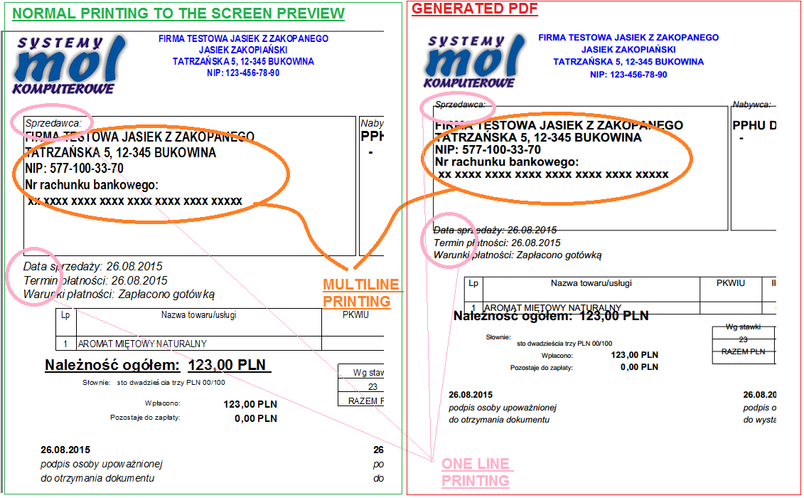

Hi Claudio!
Long time ago, I've proposed changes in H_HMG_HPDF.PRG file - add one line to correct position printed line.
In last version, this shoud be addes line 312:
nyPos -= nFontSize
This line allows the same positioning of normally printed text corresponding to multiline_print command, prining lines, rectangles.

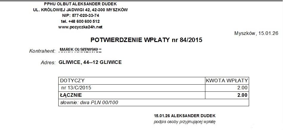

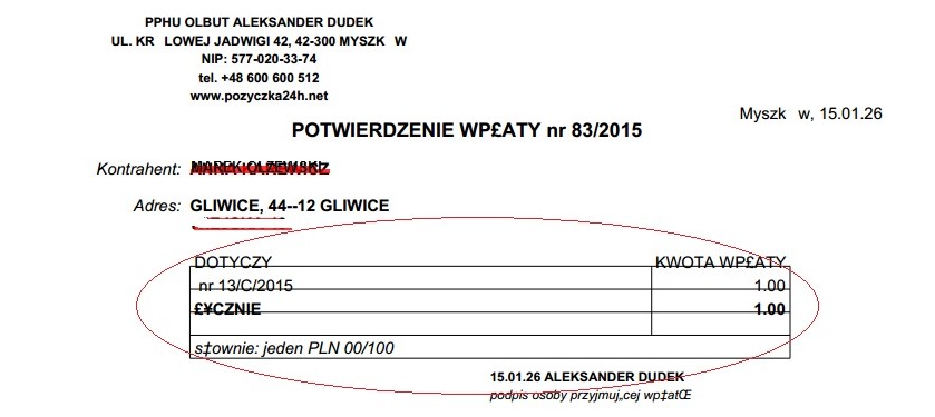

I attach sample screens:
Previous submitted pictures (from january 2015):

sorry Marek. I am the one who had forgotten to include your suggestion.
We shall include in the next version.

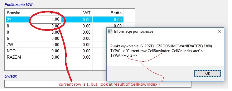

I found strange behaviour of GRID. I'm using it to edit table. When I put cursor to any row and edit data, function called by ColumnValid property get CurrentRowIndex = 0. Look at the screenshot:
What's going on?
(this was happening in older hmg version, too).

mol wrote:I found strange behaviour of GRID. I'm using it to edit table. When I put cursor to any row and edit data, function called by ColumnValid property get CurrentRowIndex = 0. Look at the screenshot:
What's going on?
Try with:
<ParentWindowName>.<GridControlName>.CellRowFocused   --> nCellRowIndex
<ParentWindowName>.<GridControlName>.CellColFocused   --> nCellColIndex
