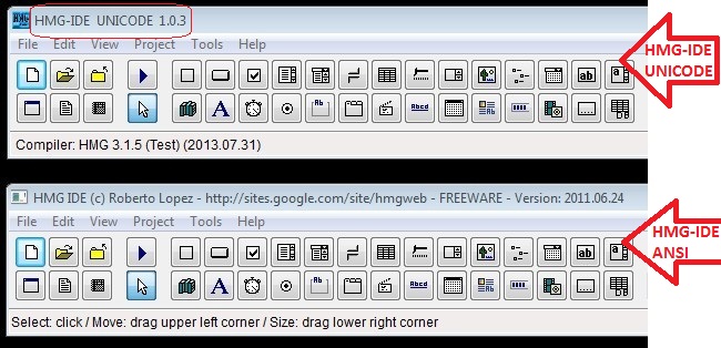

Re: HMG 3.1.5 (Test)
Hi Marek
mol wrote:It's strange because I'm sure that I'm using IDE_ANSI 1.0.3
I haven't anything like IDE_ANSI 1.0.3 :roll:
My HMG-IDE titles for HMG 3.1.5 Release
Happy HMG :D
Posts: 684
Post by EduardoLuis »
Hi Marek:
I'm using ANSI-IDE under XP SP3, WIN 7 64 bit and have no ANSI 1.03 Message on title.-
My one displays the same as indicated by Esgici (2nd. one on his graphic attached).-
Is something strange.-
