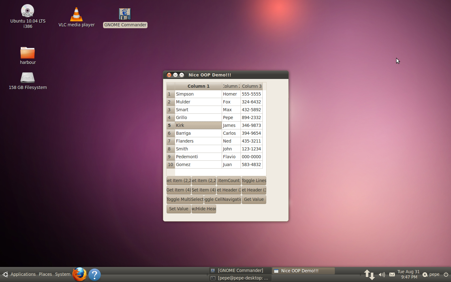

Hi Team!
Thanks to Viktor and Pritpal from Harbour team, that helped me to solve some problems, we are in Linux too!
This is the grid demo_1:
