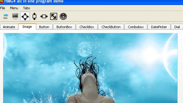

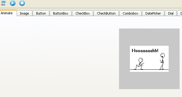

I'm sorry for these simple commits, but I'm rewriting samples/everything/demo_1.prg and testing objects.
So, I find and solve (I hope) the problems one at a time.
These are two of .... screenshot
Fig.1
screensho1
screensho1
Fig.2
screenshot2
screenshot2
Cheers
Luigi from Italy
www.L3W.it
