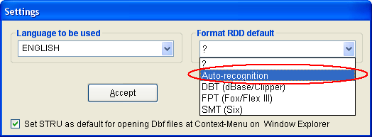

I found a mistake in the parameterization when the DBF is clicked on folder whose name contains spaces (for example, My Documents), then STRU did not interpret the path+name of the DBF because he was not quoted.
The parameter should contain quotes to receive fully the file name, as follows: C:\..\Stru.exe "%1" /G
File compressed file was actualized already for new download.
Excelent!!!!Pablo César wrote:The "Setup" option now has one more item that allows access to STRU by clicking on DBF in Window Explorer:

Thank you Daniel, I have already solved this was a UNICODE convertion for special folders in my code. The problem was when comes with latin accents, but now I've fixed. Tks.
Now I am working in MEMO extension file auto-recognizing and it is working very well...
At begining I have decided to let user or fixed format (DBT/FPT), but I've found a problem when file was not existing then the system crash... but now accessing in low level without memo file, we can know which type is. It is quite ready but I am finishing tomorrow. I am still recovering from surgery, but I believe tomorrow or on monday I finish this:
This is an Array with codes, descriptions and extension names for DBf with Memo fields. I've compoused from many sources (I hope to be in good order).
Another thing is to implement with a persistent routine for opening DBFs that I should do too.
Thanks at all for your entusiastic comments and interests.

Routine persistence for DBF opening has been implemented with also auto-recognition of type of DBF, as promissed as follows:
<Attached file removed, see last message with new release>
I hope to be enjoyed !<Attached file removed, see last message with new release>
