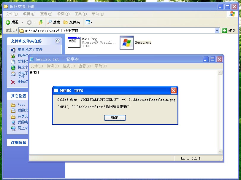

Once again, I tested the function MyGetStartUpFolder (), In ANSI mode, the function returns the correct result.

I also would agree with you about hb_U... functions are compactibles for UNICODE and ANSI modes. But... :?
I have tested my friend. Tested with this chinese characters (not our language) I and can confirm to you there is something wrong with hb_USubStr when is chinese characters in ANSI mode.
You can do by yourself this test of demo:
test.rar
Sources, Executable and chinese subfolder name
(2.57 MiB) Downloaded 247 times
But please download this, unpack and run in the chinese subfolder with name "返回结果正确" (but HMG must be rebuilded in ANSI mode). Then you will see it's working removing last backslash. Because is using SubStr intead of hb_USubStr. You can change in the code and compile (the sub-folder will be also updated too automactically). Please Claudio, test it and prove it.
