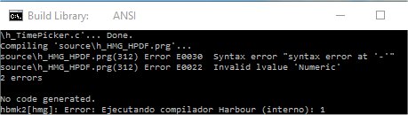

Re: HMG.3.4.2
Hola tonton2
cuando compiling BuilLib.bat
da Error.
La unica solucion que veo es subir en
nuestras aplicaciones las cordenadas
de las líneas o compilar Hmg 3.4.1
Sample:
Anterior-> @ 066,020 HPDFPRINT "Código Cliente:"
Nuevo -> @ 062,020 HPDFPRINT "Código Cliente:"
Hello tonton2
when compiling BuilLib.bat
It fails.
The only solution I see is to climb
our applications the coordinates
lines or compile HMG 3.4.1
Sample: compile HMG 3.4.2
Above> @ 066.020 HPDFPRINT "Customer Code"
New -> @ 062.020 HPDFPRINT "Customer Code"
da Error.
Sample:
Hello tonton2
It fails.
- Error.jpg (16.92 KiB) Viewed 9470 times
Re: HMG.3.4.2
bonsoir
si vous remplacer dans hmg 3.4.2 dans SOURCE/ h_HMG_HPD la ligne 312 (nyPost -= FontSize par ( // nyPost -= FontSize) il n y a plus d'erreur dans la compilation et ca marche
translation google
if you replace in hmg in 3.4.2 SOURCE / h HMG HPD line 312 (nyPost - = FontSize) by ( // nyPost - = FontSize ) he has no more error in the compilation and it works
translation google
