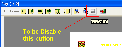

Hi Rathi and Claudio, I would like to make additional requests in this matter.
1. The enlarged option "Save as" in preview brought an inconvenient for those clients/companies do not wish to able users for saving reports. I suggest to let programmer let setted if this option could be used or not for any user. IMHO we could arrange to disable save button at preview, as Daniel Maximiliano indicated. See picture below:
With previously setting trhu a CONSTANT (for example) we probably can let it disabled this option of "save as" by the button. Here in this topic the user demand.
2. With PREVIEW option, _HMG_PRINTER_STARTPAGE_PREVIEW creates metafiles in tempory folder using TempFolder() function. I would like this option also be settable path previously by the programmer. By this, we would have all the metafiles already created in the settable path without to be saved again and in duplicity. But also will need to let it optional for deleting metafiles when is _HMG_PRINTER_ENDPAGE_PREVIEW is actioned.
3. Our friend Marek presented a solution for mask name (wildcard, template names) to use for "Save as" option in preview. I would like to make it this mask names previously, probably by setting mask priviously thru a CONSTANT before executing the preview.
Briefly:
Shall it be created 3 CONSTANTs to attend these 3 optional cases. When not used, will be acted as always came up working. Not changing. That is, while maintaining backward compatibility.
SAVE_AS := .T. or .F. (default is .T., when variable is Nil)
MASK_FILE := <Template name> (default is "HMG_MiniPrint_", when variable is Nil)
EMF_PATH := <Full path> (default is obtained by GetTempFolder()+ _HMG_SYSDATA [ 379 ], when variable is Nil)
What do you think about these indications ? Can it be implemented at HMG lib ? Do you need to I present my source codes ?
