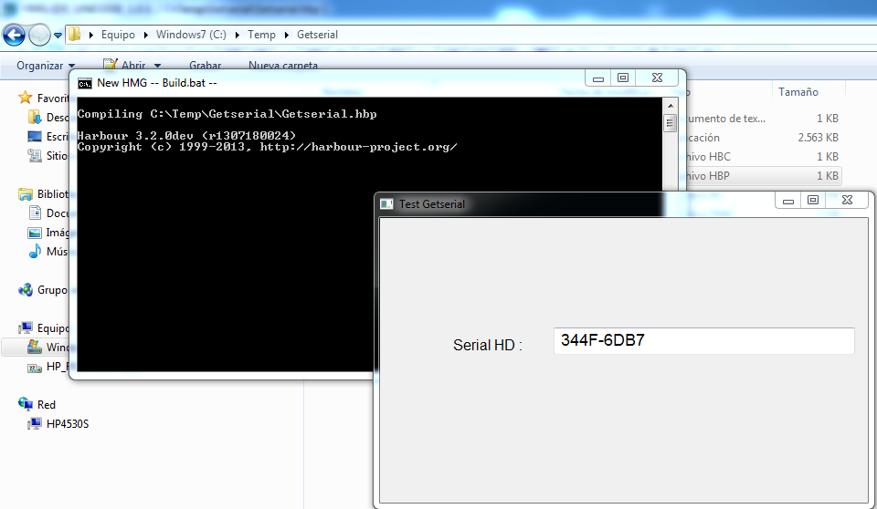

OK, Ya me funciona el ejecutable. ( quite la funcion MAKELAYER )
La funcion HDGETSERIAL("c:\") la he estado utilizando desde hace años pero no recuerdo
de donde la obtuve, ademas esta en C y siempre despliega el "warning" al compilar.

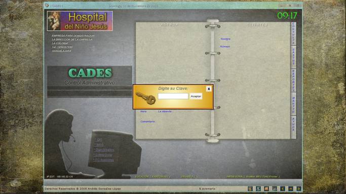

The MAKELAYER() function makes the window transparent,Here are the routines in "C":
Gracias. Thanks.

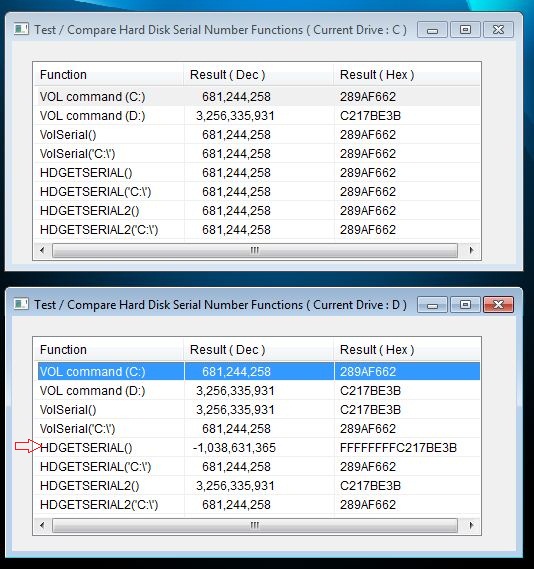

While digging my moldy archives, found two HDGETSERIAL functionsesgici wrote: It's impossible to know why it gives a different number, without seeing source code of HDGETSERIAL![]()
No any neat and useful hint but as far as I see ;
if function used by Andres is the same and
function invoked from other than current drive and
no parameter ( drive code ) specified
than it returns a negative value.
