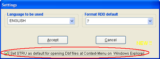

STRU - Lists and modifies the structure of the dbfs file
The "Setup" option now has one more item that allows access to STRU by clicking on DBF in Window Explorer:

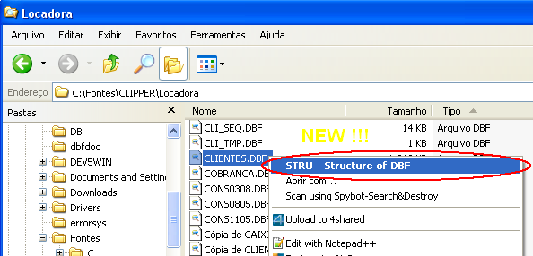

Also operates by Context-Menu of Window Explorer:
