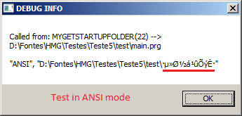

I have created a subfolder called "返回结果正确" and run it my demo and the bad result is this:
I tried Claudio to modificate GETPROGRAMFILENAME and GETMODULEFILENAME replacing GetModuleFileName by GetModuleFileNameA in trying to pass working these C functions only for ANSI. But it didn't work. :cry:
Screen18.pngThis changing to GetModuleFileNameA, it doesn't compile in UNICODE.

Your code passed well on the compiling process, but it did not work... :|
In fact I got tired of trying in various ways in C without a positive result ... so I decided to use the functions in Harbour and some result I got successfully or maybe partially with success. So I'm putting aside the C functions for both UNICODE and ANSI to get the name of the application folder being run.

This is the most I came close to getting the folder name with special characters for both ANSI and UNICODE.
But it needs to be tested because it is coming to me with this result:
In UNICODE mode, even in the Chinese language, it brings me the special characters correctly, as my example proofs that:
