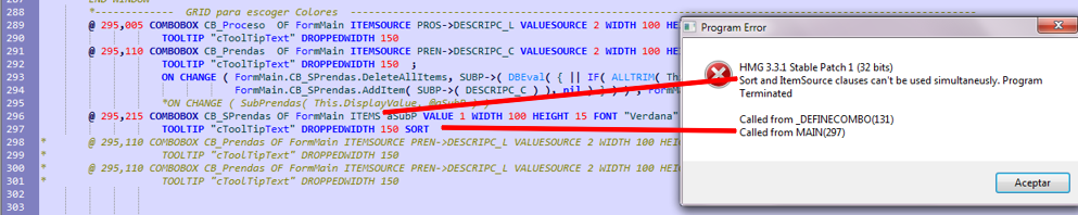

Estoy queriendo utilizar un arreglo con el COMBOBOX con la propiedad SORT pero despliega el siguiente error...???
I'm wanting to use an arrangement with the SORT property COMBOBOX but displays the following error ... ???

Re: HMG 3.3.1 (Stable)
Hi Andy,andyglezl wrote: I have a number of controls COMBOBOX, and I want to ON CHANGE will go to the next and automatically open
(to avoid several "clicks") any idea as would make ??
Please be so kind to try the following working sample:
* MiniGUI ComboBox Demo
* (c) 2002 Roberto Lopez
#include "minigui.ch"
DEFINE WINDOW Form_1 ;
WIDTH 400 ;
HEIGHT 200 ;
TITLE 'ComboBox Demo' ;
MAIN
DEFINE COMBOBOX Combo_1
ROW 10
COL 10
WIDTH 100
ITEMS { '1 | Uno' , '2 | Dos' , '3 | tres' , '0 | zero' }
VALUE 1
ON CHANGE MsgInfo ( 'On Change event' )
ON ENTER MsgInfo ( Str(Form_1.Combo_1.value) )
UPPERCASE .T.
sort .T.
on gotfocus ComboboxShowList( this.Handle )
