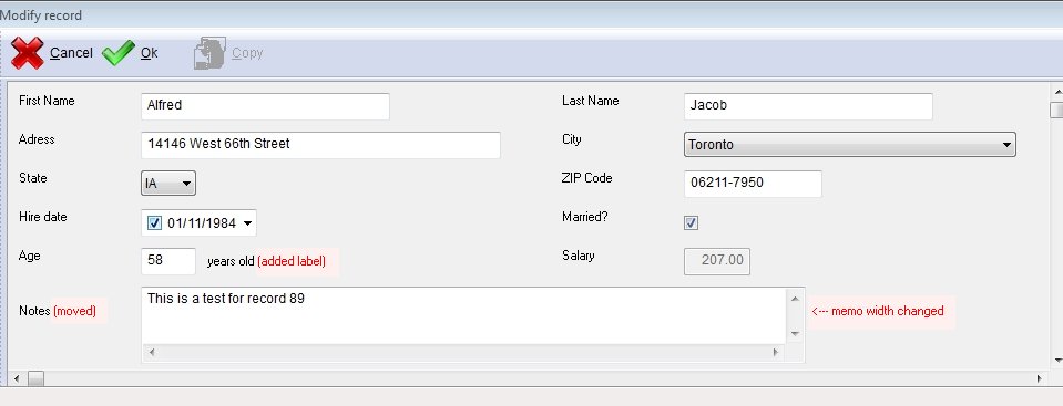

Hello
Another idea to make some specific changes to the edit screen generated by Edit Extended.
It is about passing the coordinates in a parameter added at the end. You can even add additional labels.
Also you have the combobox (in future the item list will be included as arrays)
This 11th parameter accepts "1" (1 column), "V" or "H" (2 columns) or an array (read Instructions.txt)
Run the demo and see "dbfntx demo", "ADVANCED" on the menu
I hope you like it

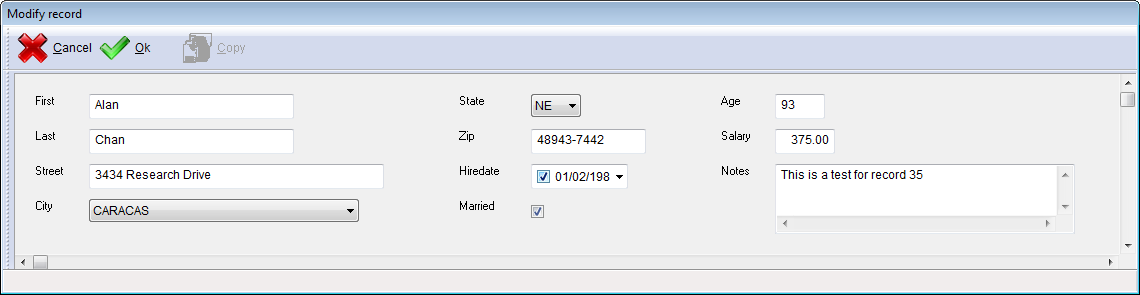

Re: Edit Extended / Edit WorkArea - ABM / ABM2
Post by rubenalf »
Hello
Thank you all for trying and commenting.
Now we have a true ComboBox, related to another table that provides the options.
There is a new parameter (the 12th). This should contain the reference to
the table and source field of the Combobox as follows: "Table-> Field"
aCombo: = {,,, "Ciudades-> City" ,,,,,,,}
ABM3 (,,,,,, aOptions ,,,, "TEST1.3h.arr", aCombo)
See demo 3 columns
I would like to have opinions on which of the methods seems more appropriate,
to avoid overloading the tool. (I mean, which one should I remove?)
