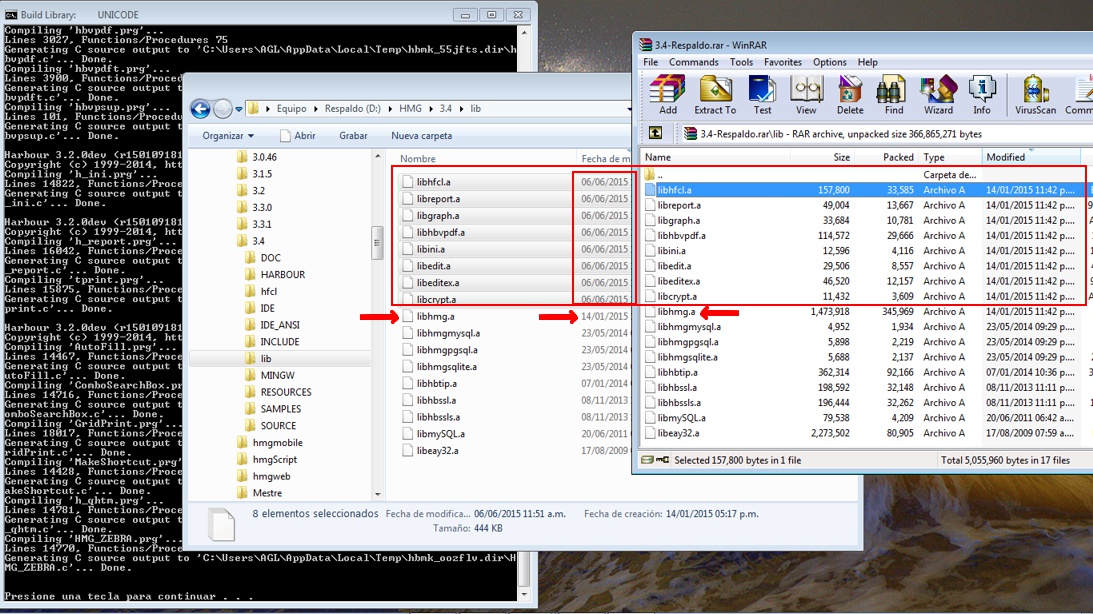

Apliqué el "hmg.3.4.0_patch_1.rar" y me dio errores al compilar y no me actualizo la "libhmg.a"
I applied the "hmg.3.4.0_patch_1.rar" and gave me errors when I compile and do not update the "libhmg.a"

You're probably using an old version of MinGW, you should use the version that accompanies hmg.3.4.0.

I've tried to apply last patch and I'm getting error while linking my app:
hbmk2: Linking... faktury.exe
C:/hmg/lib/libhmg.a(h_controlmisc.o):h_controlmisc.c:(.text+0x640): multiple definition of `HB_FUN_MY_GETPROPERTY'
.hbmk/win/mingw/inputwindow.o:C:\PROJEKTY\_faktury0\.hbmk\win\mingw/../../../.hbmk/win/mingw/inputwindow.c:1554: first defined here
C:/hmg/lib/libhmg.a(h_controlmisc.o):h_controlmisc.c:(.text+0x660): multiple definition of `HB_FUN__INPLACEEDITOPT'
.hbmk/win/mingw/inputwindow.o:C:\PROJEKTY\_faktury0\.hbmk\win\mingw/../../../.hbmk/win/mingw/inputwindow.c:1575: first defined here
C:/hmg/mingw/bin/../lib/gcc/i686-w64-mingw32/4.9.2/../../../../i686-w64-mingw32/bin/ld.exe: C:/hmg/lib/libhmg.a(h_controlmisc.o): bad reloc address 0x0 in section `.data'

multiple definition of MY_GETPROPERTY...
Hi Marek,
Please revise your code if exist this function. Probably you have it duplicated. And revise INPLACEEDITOPT too.
Rgds
Re: HMG 3.4.0
Thx Pablo!
These functions were defined in InputWindow module, which is included in patch1 now!
