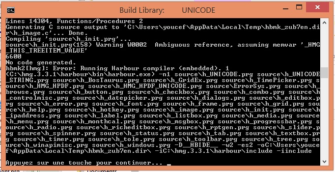

Javier Tovar wrote:Hola Tonton2,
-Solo ve a donde esta ese linea en el archivo C: \ HMG \ include \ i_tree.ch en la linea 233, y pones doble diagonal al inicio:
//_HMG_THIS_TREEITEM_VALUE
-Ejecutas el BuildAllLib.Bat
-Listo
bonsoir
When we use this
we get that error
L'Algerie vous salut

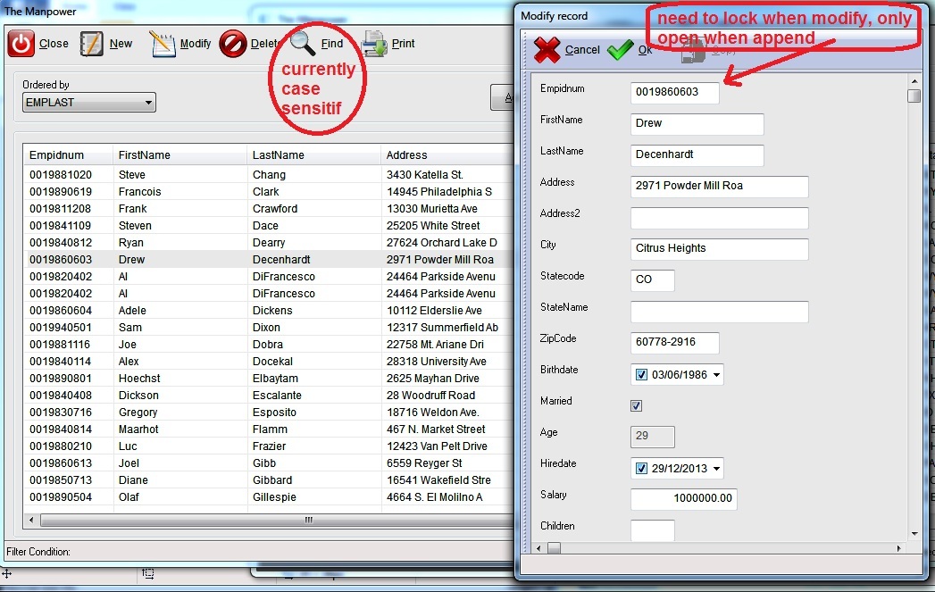

Hallo Mr.Roberto López and friends,
I need some enhancements to EXTENDED-EDIT to make it more applicable and safer to manage data in offices. What I need are :
1) add an option [FIELDLOCK [n]] to EDIT EXTENDED command, to make sure that user cannot modify the designated field when in modify-operation. But always open when in append-operation.
2) Function "Find" is subject to case-sensitive, so it always fails to find record under name "Ray" if the key is "r" ; key must be "R". Pls make it NOT case-sensitive.
3) I think more interesting to move Edit-window to the right side, instead of left side because it hides the most important info which usually put in the left (except for Arabic who reads right-to-left style).
Attacched is my test *.prg
Thanks for kind attention.
