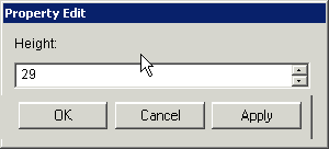

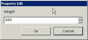

Hi all,
In the IDE, it would be very useful to have an option (button) "Apply" in the values window of Controls, so you'll see the result of a value in the form, without having to reopen the value window, which closes when we press the “OK” button. I do not know how difficult it is, but I think we would save a lot of time... :idea:
Best Regards,
Nikos.

Re: HMG 3.1.5 (Test)
quartz565 wrote: In the IDE, it would be very useful to have an option (button) "Apply" in the values window of Controls, so you'll see the result of a value in the form, without having to reopen the value window, which closes when we press the “OK” button. I do not know how difficult it is, but I think we would save a lot of time... :idea:
Hi all
I agree with Nikos :arrow:
More, IMHO an extra "Apply" button may not required; when changed value of any property of any control, if the new value echoed to form will be very useful.

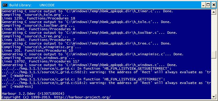

Hola
Instalé la version 3.1.5 y el parche "HMG.3.1.5_patch2.rar", corrí el "BuildAllLib.bat" y en la generacion
de las librerias, desplegó unos mensajes con error.
Despues compilé mi programa, me desplegó unos mensajes "warning" y me generó el ejecutable,
pero al correrlo, se congela y no hace nada.
Esto es lo que genera el archivo build.log.
Harbour 3.2.0dev (r1307180024)
Copyright (c) 1999-2013, http://harbour-project.org/" onclick="window.open(this.href);return false;" onclick="window.open(this.href);return false;" onclick="window.open(this.href);return false;" onclick="window.open(this.href);return false;" onclick="window.open(this.href);return false;" onclick="window.open(this.href);return false;" onclick="window.open(this.href);return false;
conad.prg: In function 'HB_FUN_HDGETSERIAL':
conad.prg:8007:5: warning: passing argument 1 of 'Get_SerialNumber' discards 'const' qualifier from pointer target type [enabled by default]
conad.prg:7998:19: note: expected 'char *' but argument is of type 'const char *'
conad.prg: In function 'HB_FUN_MAKELAYER':
conad.prg:8239:9: warning: implicit declaration of function 'SetLayeredWindowAttributes' [-Wimplicit-function-declaration]
Warning: resolving _SetLayeredWindowAttributes by linking to _SetLayeredWindowAttributes@16
Use --enable-stdcall-fixup to disable these warnings
Use --disable-stdcall-fixup to disable these fixups

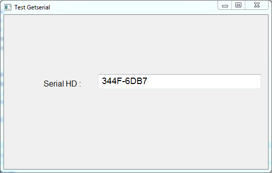

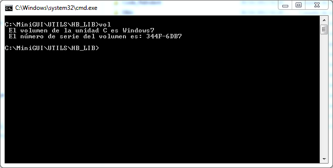

Hola Andrés :
desde HMG.3.0.46 a HMG.3.1.5 hubo cambios en Harbour, este inconveniente no es propia de HMG, sino que cambiaron dentro de las funciones que te aparecen en el LOG que genera Build.bat
para saber leer el serial de un HD en linea de comandos D.O.S
para HMG/Harbour
Public cSerial := ""
Public nSerial := VolSerial( "C:" + HB_OSpathseparator() )
        Load Window Main
        Main.Center
	 cSerial:=NumToHex( nSerial )
   cSerial:=Stuff(cSerial,5,0,"-")
   Main.Text_1.value := cSerial
        Main.Activate
