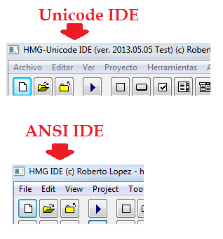

quartz565 wrote:Hi,
If i edit forms in IDE (Unicode version) the Greek characters are not displayed (ide_edit). But there is no problem with Greek characters in exe Program (exe_prog)
What should I do to fix the problem.
Nikos
Hi Nikos,
Please, check that the IDE.EXE open is correct.
The picture you show is typical of a project in Unicode open in an IDE in ANSI.
Best Regards,
Claudio.

Hi Nikos,
Not exist any problem with the use of HMG-Unicode with ANSI program, only you must use ANSI IDE and set the correct CODEPAGE in your application.
The benefit of Unicode is to write your application in any langue of world without worry if supports or not the CODEPAGE of your lenguage in the system of user.
Best Regards,
Claudio.

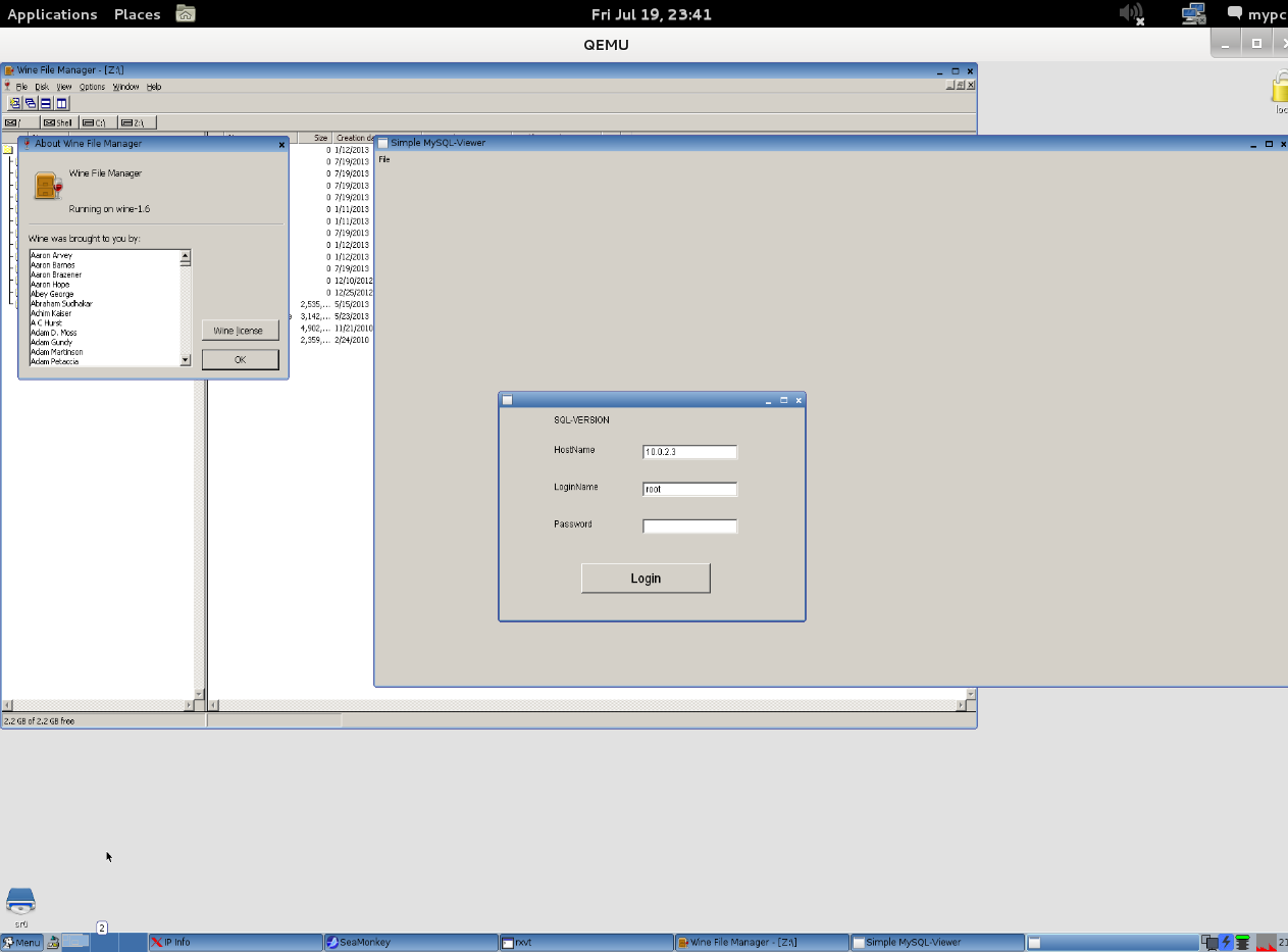

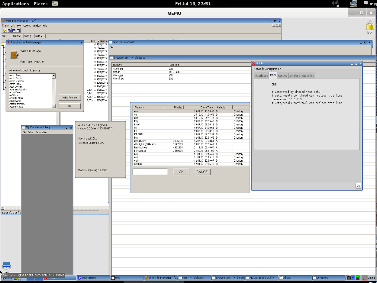

Hi,Roberto,Rathi,Doc and All Others.
Mysql works.
Just use HMG-Program and libmysql.dll .
I heard, that Mysql 5.5 is somewhat incompatible.
So use for windows/wine libmysql.dll 5.5.
With 5.1.x any libmysql will do.
I tested all in a Qemu-KVM virtual Environment.
Worked fine.
Here is the line
kvm -smp 2 -cpu core2duo -m 2048 -vga vmware -cdrom puppy_mysql.iso -net nic,model=e1000 -net user
10.0.2.3 -- DNS or 192.x.x.x on a real NET-PC
Just like a real PC-Environment.
I added to Pics with Wine1.6 Final.
So if we substitute 10.0.2.3 with the IP-Adress
of our Linux-Mysql-Server it is all the same for
Wine and Windows.
A simple Linux-Mysql-Server with Wine installed is
just the same for HMG-Development as a Windows-WAMP-Machine.
The Wine-Translator is fully grown up it seems.
Viva HMG,Harbour and the wonderful community.
:D :D :D
Best wishes from Germany to wonderful Community.
klauskugel
