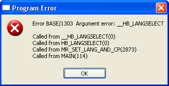

I have tried but unsuccessfully. It is compiling without error, error only happening at runtime displaying:
I suppose that need to add #include "hbapilng.h" but another errors is coming by this include: C:\hmg.3.0.44\harbour\include\hbdefs.h(56) Error F0029 Can't open #include file 'stdarg.h'
So, I need to know what I am doing wrong...

Are you using HMG 3.0.44 ?
If Yes: Try this code:

YesChacal.GO wrote:Are you using HMG 3.0.44 ?
I have tested by your tow indications, taking off (making like comments) like as:
// SET LANGUAGE TO PORTUGUESE
// SET CODEPAGE TO PORTUGUESE
then
MR_Set_Lang_and_CP()
But the result is not correct displayed when STRU is in console mode. Even using:
cText_to_be_displayed := hb_translate( cStr, "PT850", "UTF8") The strange is when I try to use by this way:
cText_to_be_displayed := hb_translate( cStr, hb_UserLang(), "UTF8") // this is with error when try to compile.
Anyway seems is not going to work properly even lng files been in Unicode.
