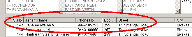

Posted: Tue Aug 04, 2015 1:32 pm
Does anybody else have this problem in Grid headers backcolor?
Please see the difference between compiled in previous version and current version.
My target system is WinXP.
In Windows 7 it works ok and shows no difference.
Re: HMG 3.4.1
Posted: Tue Aug 04, 2015 2:25 pm
by dhaine_adp
Rathinagiri wrote:Does anybody else have this problem in Grid headers backcolor?
Maybe it has something to do with Win XP theme?
Re: HMG 3.4.1
Posted: Tue Aug 04, 2015 5:19 pm
by EduardoLuis
Hi Rathi:
About your questión, i agree with dahine, may be an skin trouble with XP default theme.-
I don't experiment such difference as you describe.- On my XP SP3 target system I've installed since long time skin Vista Inspirat Ultimate 2, so my screens look and also my clients too screens with XP looks fantastic bether than vista.-
This skin theme contains Aero, so effect like transparences all fully accesible.-
If you or anybody want to install it go to:
http://www.crystalxp.net/galerie/en.id. ... -packs.htm
It works with XP (SP3) under 32 bit. no mather how much ram have's your hardware; in my "tests machine" i've only 512 mg ram, and looks and works excellent.-
Hoping these helps you and everybody.-
With regards.
Eduardo
