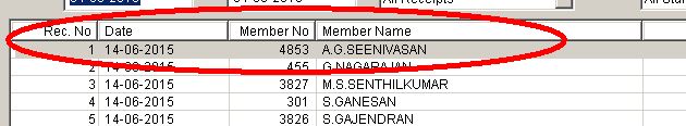

Re: HMG 3.4.1
Does anybody else have this problem in Grid headers backcolor?
Please see the difference between compiled in previous version and current version.
My target system is WinXP.
In Windows 7 it works ok and shows no difference.

Maybe it has something to do with Win XP theme?Rathinagiri wrote:Does anybody else have this problem in Grid headers backcolor?

- Posts: 684
Re: HMG 3.4.1
Hi Rathi:
About your questión, i agree with dahine, may be an skin trouble with XP default theme.-
I don't experiment such difference as you describe.- On my XP SP3 target system I've installed since long time skin Vista Inspirat Ultimate 2, so my screens look and also my clients too screens with XP looks fantastic bether than vista.-
This skin theme contains Aero, so effect like transparences all fully accesible.-
