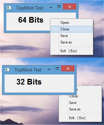

I'm afraid that we have a problem with TOPMOST property of DEFINE WINDOW statement :(
PROC Main()
    DEFINE WINDOW frmTopMostTest ;
        AT 0, 250 ;
        WIDTH  250 ;
        HEIGHT 100 ;
        TITLE "TopMost Test" ;
        MAIN ;
	    TOPMOST
        ON KEY ESCAPE ACTION frmTopMostTest.Release
        DEFINE CONTEXT MENU // OF &cFrmName
            MENUITEM "Open"                 ACTION MsgBox( "Open" )
            MENUITEM "Close"                ACTION MsgBox( "Close" )
            MENUITEM "Save"                 ACTION MsgBox( "Save" )
            MENUITEM "Save as"              ACTION MsgBox( "Save as" )
            SEPARATOR
            MENUITEM "Exit   ( Esc)"        ACTION ThisWindow.Release
         END MENU
      END WINDOW // frmTopMostTest
      frmTopMostTest.Activate
RETU // Main()

Hola amigo esgici
El problema por ti reportado veo que solo
pasa en 32 bits en 64 bits, sale bien.
Saludos.
Hello Esgici friend
The problem reported by you only see
happens in 32 bits in 64 bits, it goes well.
Greetings.
