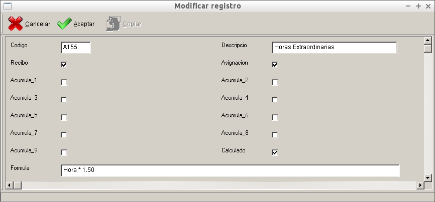

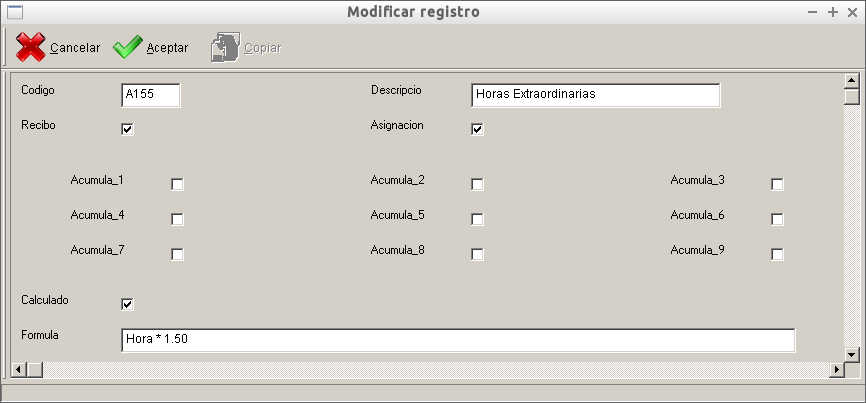

Re: Edit Extended / Edit WorkArea - ABM / ABM2
Hi.
Finally it works .
Modification to alter the position of the controls.
It should be called as follows:
I did not try with different parameters . Probably it will fail
Attached comparative images with some changes
I hope someone like it

Finally it works .
LOCAL aOptions := Array( 1, 2 )
aOptions[1,1] := "Edit Control positions"
aOptions[1,2] := { || ModificarArray() }
ABM2("dbName", , , , , , aOptions )

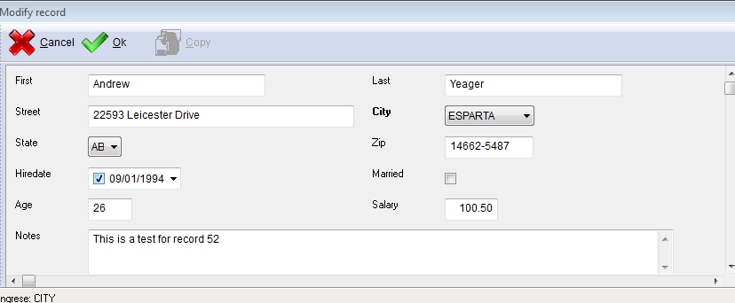

Hi all
(Español más abajo)
I have made some changes on Edit Extended to get ComboBox’s
This change is not related with any other change I have made
(I can easily made it over the original "h_edit.prg", if anyone ask for it)
You do not need to pass any parameters, only you must create a
simple function for each ComboBox needed before calling ABM2()
The function will be named “CB_dbasename_fieldname()”. That is:
“CB” → ComboBox
dbasename → name of the related .DBF file name (or alias if used)
fieldname → name of the related text FIELD
If the respective function is found, it will be used to make a ComboBox;
other way a standard TextBox is made.
The function should return an array with the list of options (see demo.prg near line 100)
I hope this be helpfull por someone else. I feel still this is a great tool.

(Español más abajo)
“CB” → ComboBox
