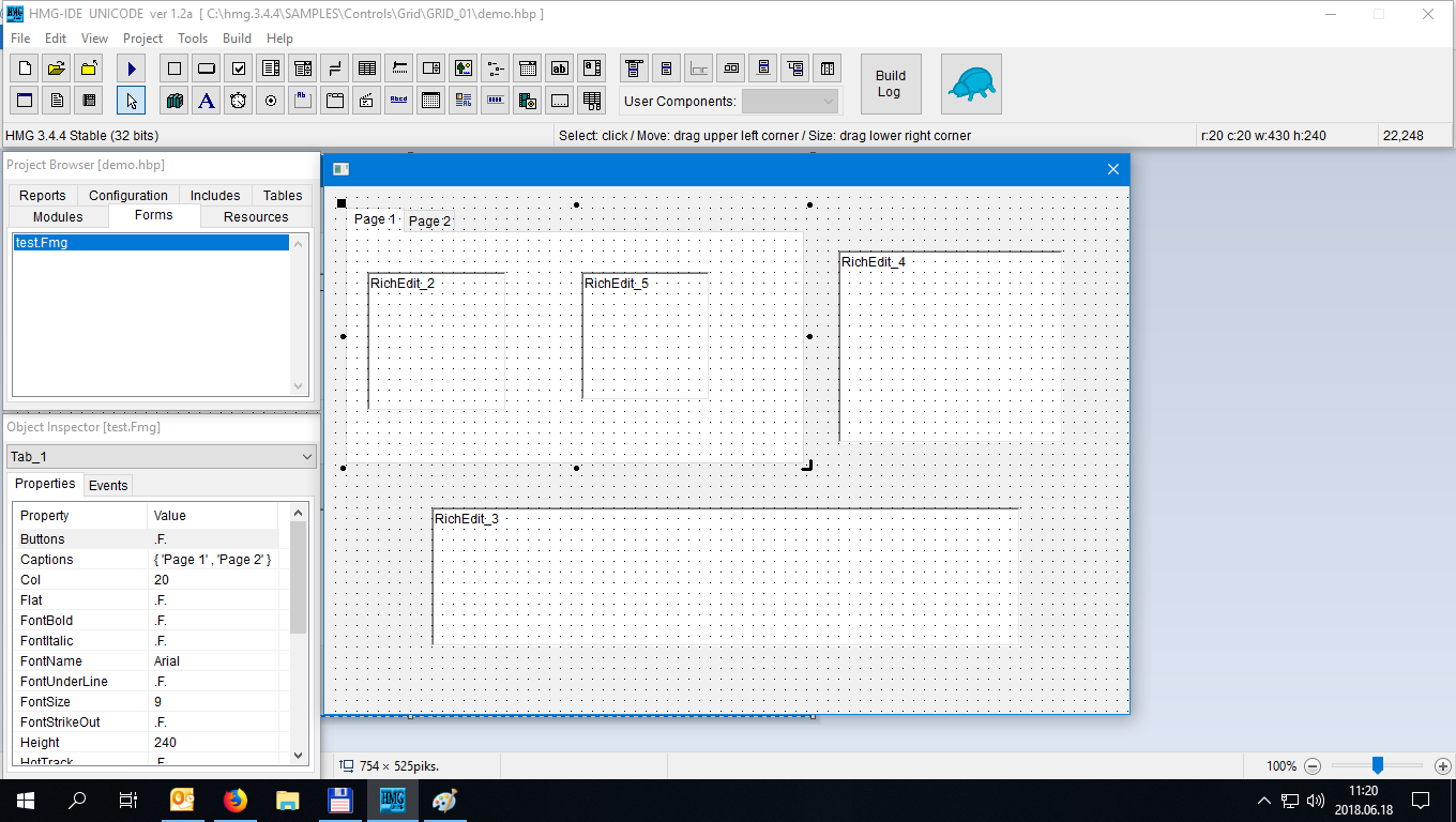

Hi Guys!
I'm trying to add RichEditBox control to the Tab.
It causes IDE error:

Re: HMG 3.4.4
Sorry Marek, but I can not reproduce this issue
Re: HMG 3.4.4
Try to add richeditbox on second tab
PS. I'm using ANSI version of IDE
Re: HMG 3.4.4
On second tab is also OK, but... if I load the form to IDE-ANSI, all RichEditBoxes disappears!
While saving the form occurs errors as you report.
Re: HMG 3.4.4
When I add RichEditBox to second Tab, it disappears - it looks like RichEditBox is placed under the Tab.
When I try to save form - error occurs.

Re: HMG 3.4.4
I think the problem is with IDE Ansi version. I didn't test UNICODE version.
But, we can not try to resolve it while we have no access to source code of IDE.
