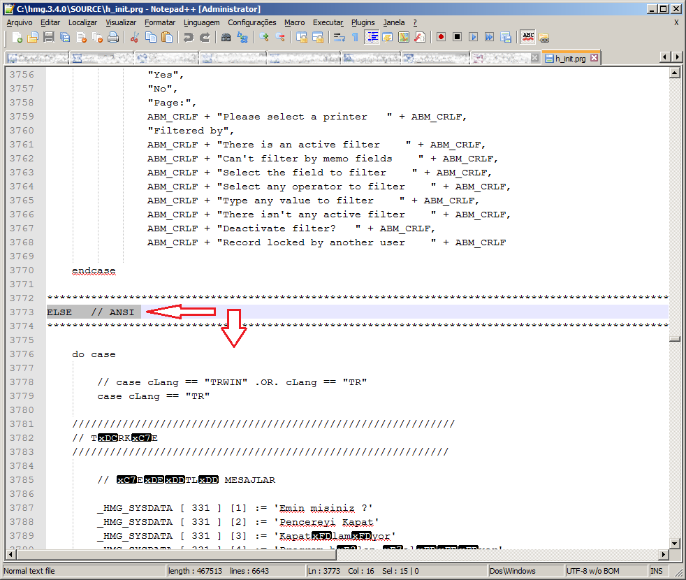

Re: HMG 3.4.0
Pablo César wrote: I do not see any problem... :|
Probably you are looking only Spanish section (case cLang == "ES")
and for see the problem, require open .prg file with a UTF supported editor :?
HMG 3.4.0

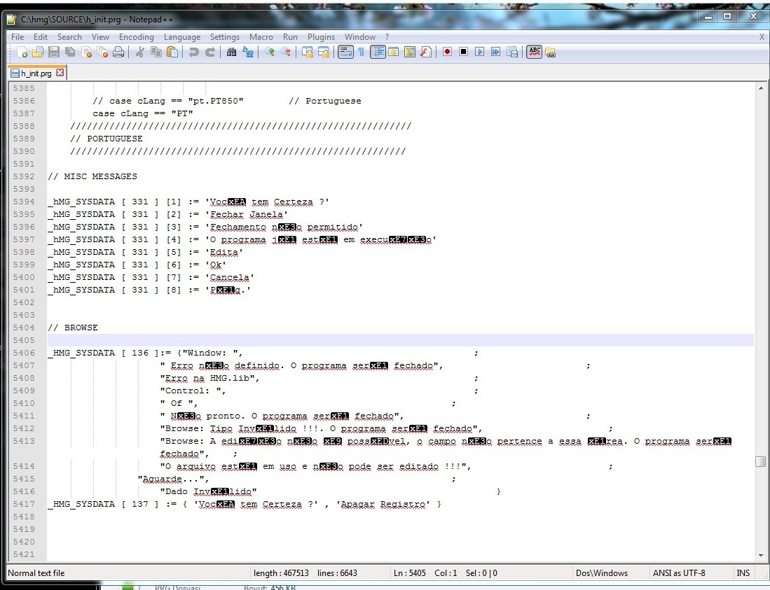

Sorry, but I am still thinking this should be correct because this part where you have shown Esgici is for ANSI and when is being displayed at UNICODE editor format is showing this strange characters. But IMHO this is correct do not need to be rewritten by the reason is in ANSI displayed at UNICODE mode. It's like two codes with different format but in only one file in UNICODE format.
I'm saying that after seing your above picture. Following picture is showing upper line where you have indicated is in ANSI:
I never used in ANSI, anyway but probably I'm wrong.
Lets wait for Claudio's informations to confirm if is needing re-write this strange characters.
Re: HMG 3.4.0
Pablo César wrote:Sorry, but I am still thinking this should be correct because this part where you have shown Esgici is for ANSI and when is being displayed at UNICODE editor format is showing this strange characters. But IMHO this is correct do not need to be rewritten by the reason is in ANSI displayed at UNICODE mode. It's like two codes with different format but in only one file in UNICODE format.
You are right; my example screen-shoot is wrong; I didn't care IF HMG_IsCurrentCodePageUnicode ... ELSE ... ENDIF structure :(
( By the way, what long block :o )
In other hand, my language block is between line 914 - 1104 ( into Unicode section ) sadly wrong and need manual intervention. PL block between 2346-2519 is the same.
In short, our translator friends need look at Unicode section ( between lines 908-3773 ) and make correction if necessary.
Thanks to warn.
Viva HMG :D
