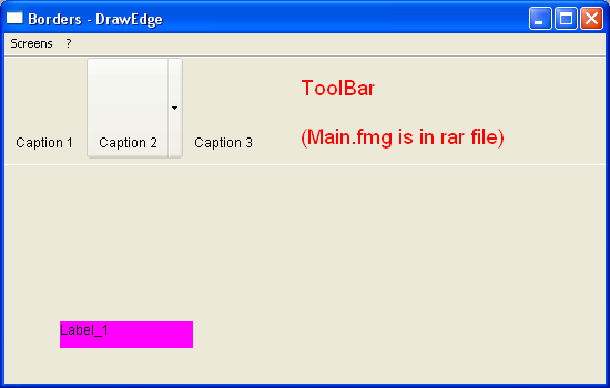

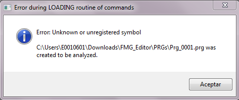

Hi, pablo
When I load the form "Main.fmg" included in the FMG_Editor Folder I have the next error. Removing the toolbar "ToolBar_1" in the "Main.Fmg" form, that error is solved.
Date:05/06/14 Time: 14:43:46
 Version: HMG 3.2.0 Stable Patch 2 - FMG_Editor  LOADING
Error: Unknown or unregistered symbol
 Called from EXE_FUNCTION(1037)
 Called from LOAD_FMG(468)
 Called from OPEN_FORM(353)
 Called from (b)MAIN(34)
 Called from (b)MAIN(120)
 Called from _DOCONTROLEVENTPROCEDURE(5622)
 Called from EVENTS(1640)
 Called from DOMESSAGELOOP(0)
 Called from _ACTIVATEWINDOW(5290)
 Called from MAIN(185)
Thanks Again,
Ed

Hi Eduar, attach the Prg_0001.prg file, please.
Because for me here is working:

Pablo, FYI
Prg_0001.rar
(881 Bytes) Downloaded 333 times
Thanks Ed

No pude todavia ver este problema Eduar. Pero me parece que tiene relacion con haber re-editado el archivo y quedado con el formato UTF-8.
