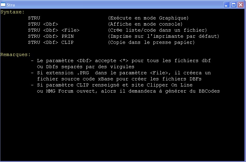

To improve the support of other languages, I try to modify the help screen. I modify Copie to Crée in French.lng and I got this error on the screenshot (see attached file).
Screenshot help
Screenshot help
I see... check now.
If you make improvements in French.Lng, please share with us.
<Attached file removed, see last message with now release>

I have checked : now it is OK. That is super!!!
You will find attached an updated version of the translation in French : mostly typo errors.
