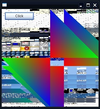

Hi Rathi
Wonderful for starting :D
I've a little overcharged the test ;)
At the beginning, that is after first click of "Click" button, and continuous clicking is causing randomly filled screen background under last drawn two triangles. :(
Does this caused by my graphic card ? But no problem anyway in other usage of it :?
I'm waiting eagerly other drawings by our new lib "libhmgl" :)

Re: HMG and OpenGL
esgici wrote:Hi Rathi
I too confirm the problem in Windows XP.
The sample runs fine in Vista.
I am working on that.
