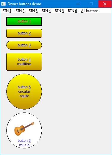

you can use OWNERDRAW, for every Windows Control, to draw Your own Background and Style
look for
Owner button functions for HMG 3.4.3
Author: KDJ
Version: 2017-01-23
https://www.hmgforum.com/viewtopic.php?t=2397

as i can say BUTTONEX is based on KDJ Version of Ownbutton using BS_OWNERDRAW

you can´t set BS_OWNERDRAW after Create. the Type must be set at Create Time.
you seems not to understand Ownerdraw, it mean that all Action will be Problem of User, not SYSTEM any more.
it is not only Form, Style and Color you also need CODE for Action e.g. when got Focus or when lost Focus.
ownerdraw is allways need, when want a Control which look different than "normal by Windows"

mol wrote: Mon Nov 25, 2024 5:59 pm Can somebody place any working sample?
https://www.hmgforum.com/download/file.php?id=7427
